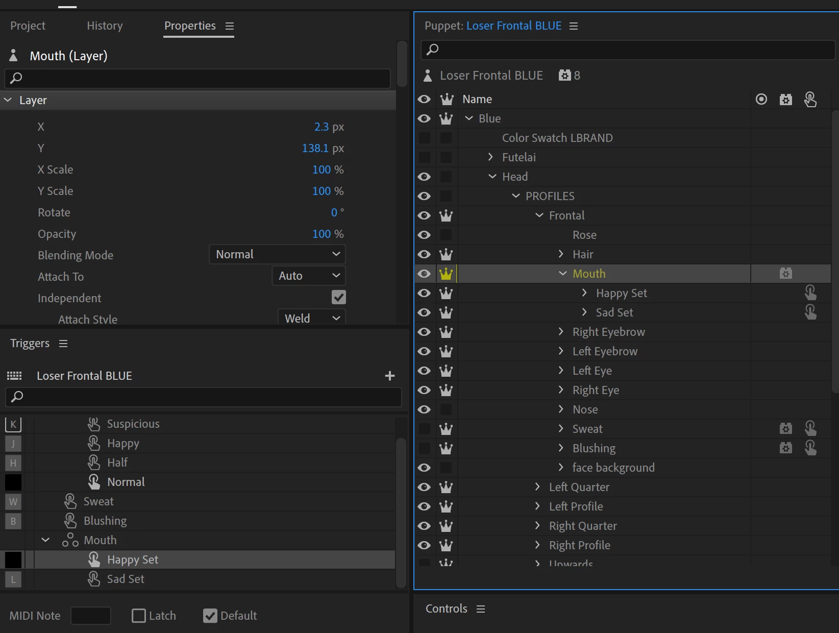

Heyy, thanks for your answer.
Yes I did do something out of the box, cause otherwise the mouth swap set won`t work, when the puppet has only one lip sync behaviour at the puppet level, as it should be normally, only the default set works, the sad set won`t work, it shows that it`s changing to the sad set but not lip syncing, it solely shows the mouth shapes there. I`ve tried everything, but only adding a new lip sync behaviour to the frontal/mouth group makes it work, hence if i added a lipsync behaviour to each mouth/ profiles & swap faces I`ve ended up with 10 compute lip syncs, does this make more sense?
Hierarchy I think it should be fine but you have a look maybe can spot something, also all the other triggers work just fine, it`s just the mouth set that I can`t get around to make it work without adding the additional lip behaviour, and that`s actually keeping me stuck with this.
See the screen shot below and please do let me know if you know of anything that might work in this case?!
Much appreciated
Alex
alank99101739
Nov 7, 2020 9:17 PM UTC
I think the visemes have to be immediate children of Mouth. I often do:
- Gobs (slang for mouth)
- - Sad Mouth (space between words so gets tagged as mouth)
- - - Neutral
- - - Ah
- - - etc
- - Happy Mouth (space between words)
- - - Neutral
- - - Surprised
- - - Ah
- - - etc
Then I put a swapset on "Gobs". I was going to check up on using one LipSync behavior on multiple mouths, but CH refused to start for some reason - maybe time for a reboot! I look at Face and LibSync etc face views/handles/etc to see what they bound through to as well. E.g. did it bind to both Mouth layers? Then the visemes under the mouth layers?
