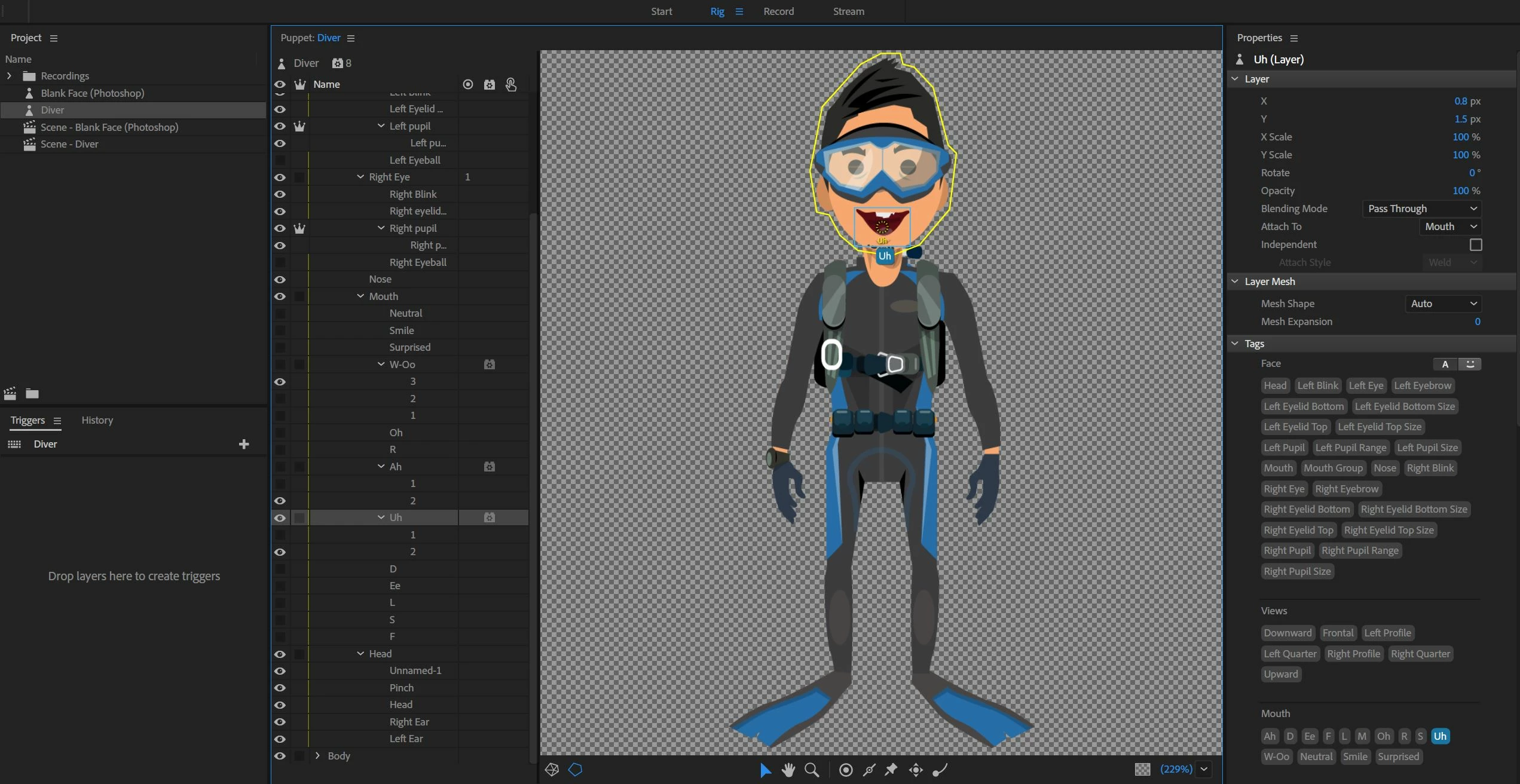

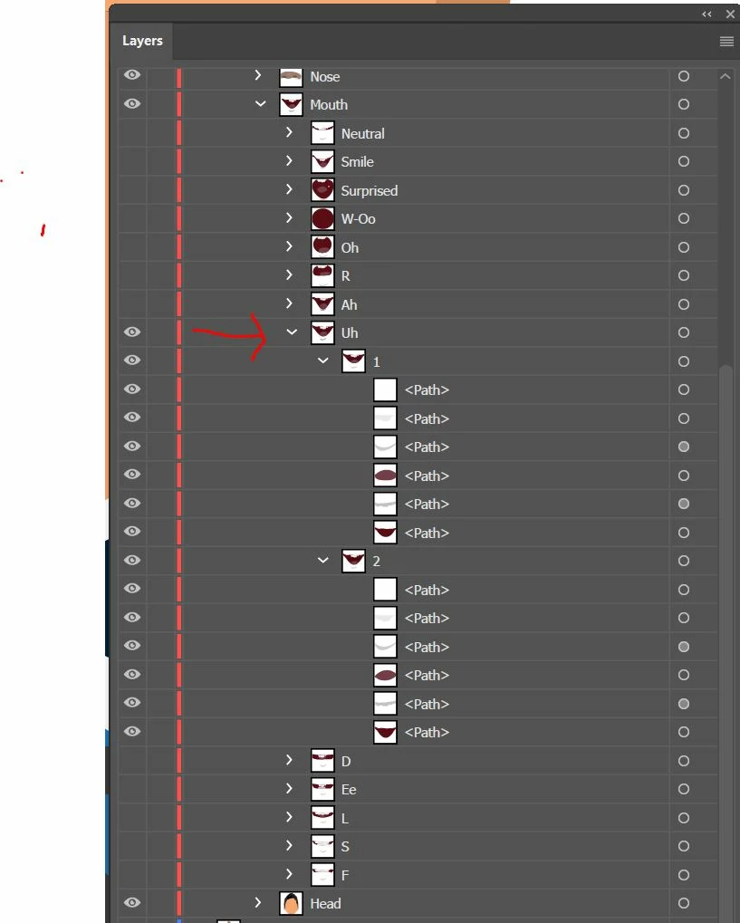

Thanks for the info, I doubled checked and cant seem to find anything wrong, maybe I'm blind sighted by my will to succeed.  Here are some screenshots.
Illustrator file layer
Here is my puppet view
