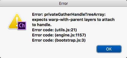

    Just as an addon.... When I Right Clicked the Group and selected the Reset Layer option... I got an error message...

    Yes, this is how it works currently - the group and layer are separate entities, we have to account for the group and its origin even if you move something inside of it. In general I'd recommend doing your layout in PS or AI as it's not CH's greatest strength right now - it can be slow going.
    Is it possible to share a .puppet file with the puppet you've made pre-error message? That sounds like a bug.

    I do as you suggest and work in the original file. It's only when I read the threads here that I start looking deeper... The Reset Layer works well with Layers, it was only when I started trying it with Groups. i thought as it was there... it may reset all the layers withing the Group.
    I've just told Dave that I don't keep my working/tutorial stuff... not really a project... I clear my system and start afresh each day.
    Next time it happens I'll export the Puppet file and send it to you.
