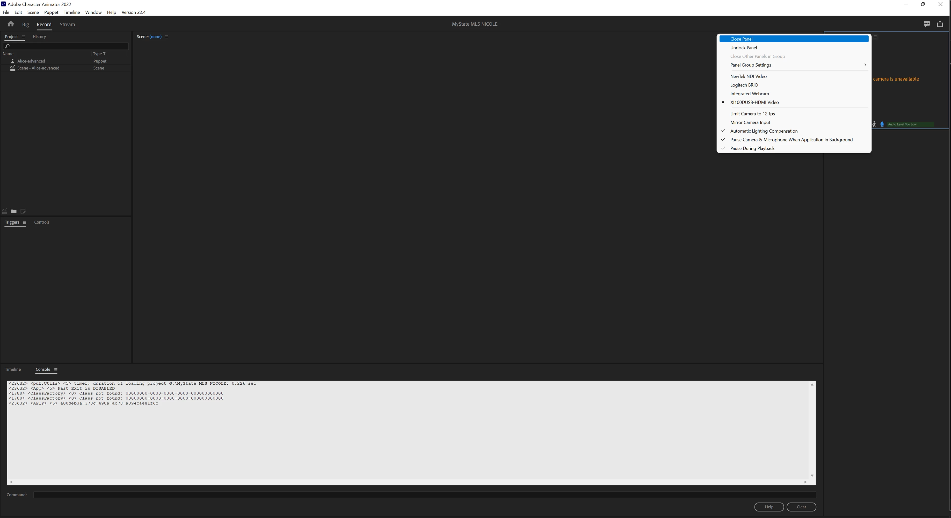

The first thing to do is open the camera panel and check to make sure that your webcam is selected as in this picture:

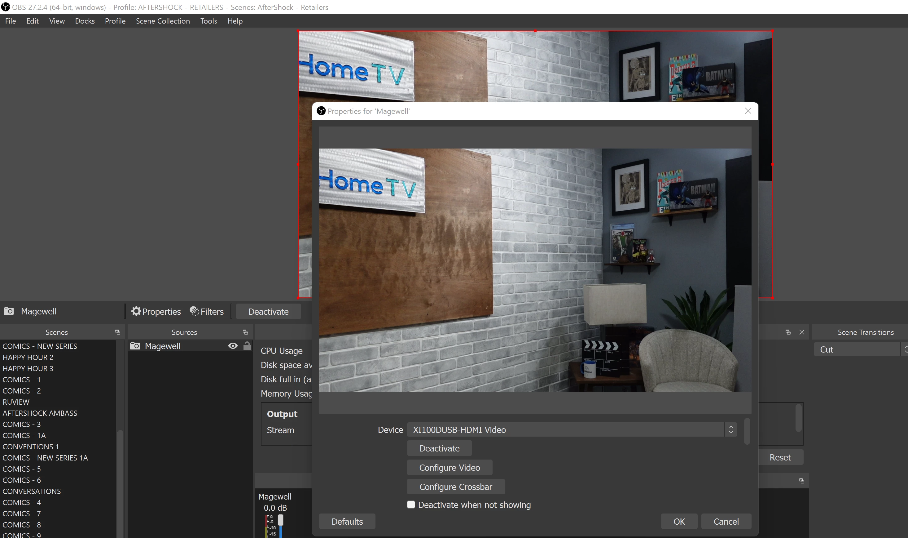

Jun 3, 2022 5:35 PM UTC
Yep. I had the Magewell selected. I'm including a screenshot showing it selected and that Character Animator showing that it is unavailable. I'm also including a screenshot of the camera feed working in OBS, and just to clarify, the two applications were not running at the same time. So, there wasn't a conflict of the two apps trying to ingest the same feed.
