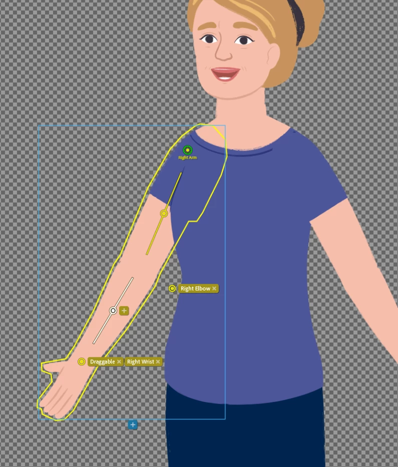

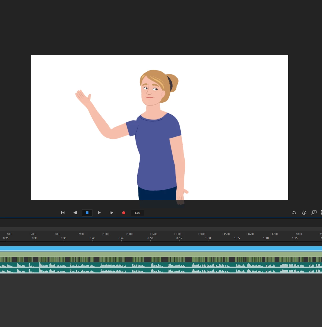

I'm setting up my first character in Adobe Character animator. Butmy shoulder is bending in a wierd way when I move it up. Do you have any ideas of what I can do to fix it?

Yeah, the origin (green circle thing called Right arm) is where your arm will rotate around. Changing that position should help determine how and where it rotates from. It also looks like your elbow tag is outside of your arm - I would move that to where the elbow actually is. And finally I would play with hinge vs. weld attach styles when you have your arm selected in the upper right corner - one might work better for your character than the other. Adding the shoulder tag as suggested should help with Limb IK calculations as well.

TheOriginalGC
Apr 12, 2024 12:31 PM UTC
Would it be possible for you to share a screenshot of the arm rigging for the puppet?
Apr 12, 2024 1:34 PM UTC
Yes, it looks like this.
TheOriginalGC
Apr 12, 2024 2:09 PM UTC
I see that you do not have a shoulder tag on the arm's origin point. Try adding one there and see if that helps.
