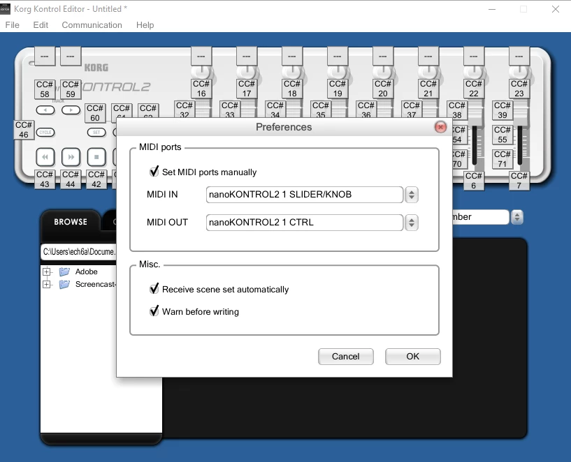

The MIDI device I have is the Korg NanoKontrol2, which has a good number of sliders and dials.  I have already installed the drivers and the KorgKontrol Editor, but I have no idea how to set it up so that Adobe Character Animator recognizes the MIDI board so that I can map certain triggers to the buttons and dials.  Despite pouring over all of the MIDI posts on this forum and all of the related Korg information and I am at a TOTAL loss!
If someone would just help push me in the right direction, I would really appreciate it.  To begin, do I need to install a different type of DAW software, or is the included Korg Kontrol Editor (screenshots included below) all I need to connect to Character Animator and assign my triggers?

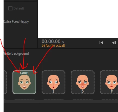

EXCITING UPDATE - I DID IT YOU GUYS!!!  I was able to successfully map a note onto a button, and Character Animator is recognizing and registering these buttons.
Woohooooo.  What a great day!  Thanks to KJerryK​ and alank99101739​ for your assistance here !

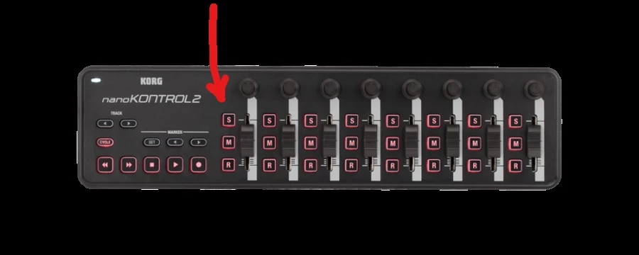

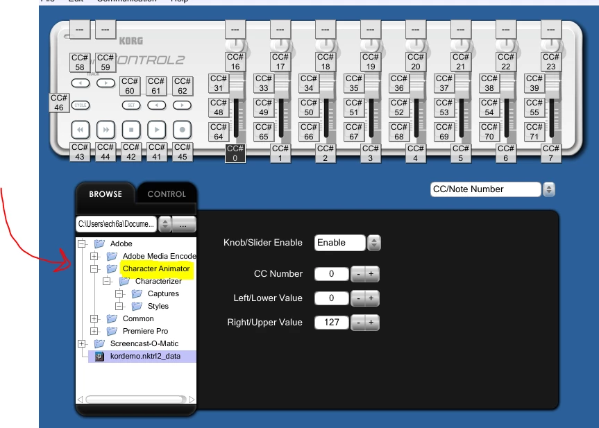

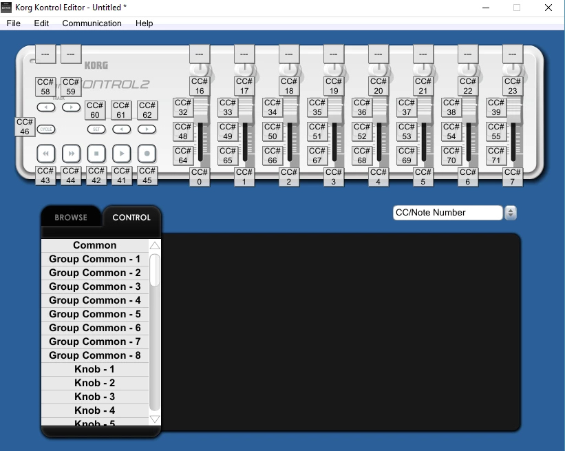

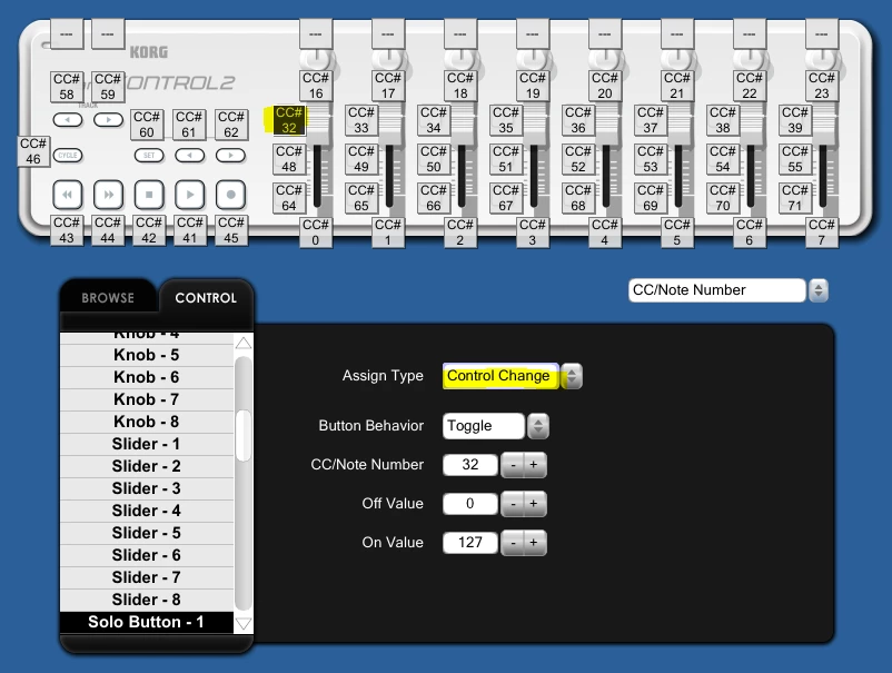

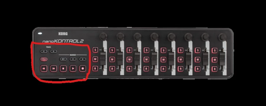

So it seems that Character Animator DID recognize the nanoKontroller.  Now I'm looking at the rest of the controller (pictured below) and I have a lot of other buttons, including a set of Stop, Record, and Play buttons.  I'd like to map them out so that when I press them, the corresponding functions are set off in Character Animator.  Is there anything I need to do within Character Animator to achieve this?  I think this is something I would set up in the Korg Kontrol Editor, but I don't know if anyone is familiar with a software like this.  It looks like I can program the board for different applications (which I think they call "Scenes"?), but I am unable to find or click on "Character Animator" in order to select it.
Also, is there any way I can use these buttons to activate triggers in Character Animator?  So that when I click on the trigger and press the button on my nanoKontrol, it will "lock" that button onto the trigger?  The buttons can be turned into "notes", which could be a key.
I think I may have to save my changes or "write the scene data" in order for these changes to take effect.  All I know is that if I press any of these buttons when my trigger is highlighted in the control panel, nothing is happening in Character Animator.
BUT as I mentioned before - my main problem has been solved!  I'm just glad I can use these toggles and sliders .  So if you guys have absolutely no idea what I'm talking about don't go overboard trying to figure it out for me.  I don't even have any idea if this Korg Kontrol Editor even resembles a DAW or any other type of recognizable software, so I thought I would get some feedback here.
