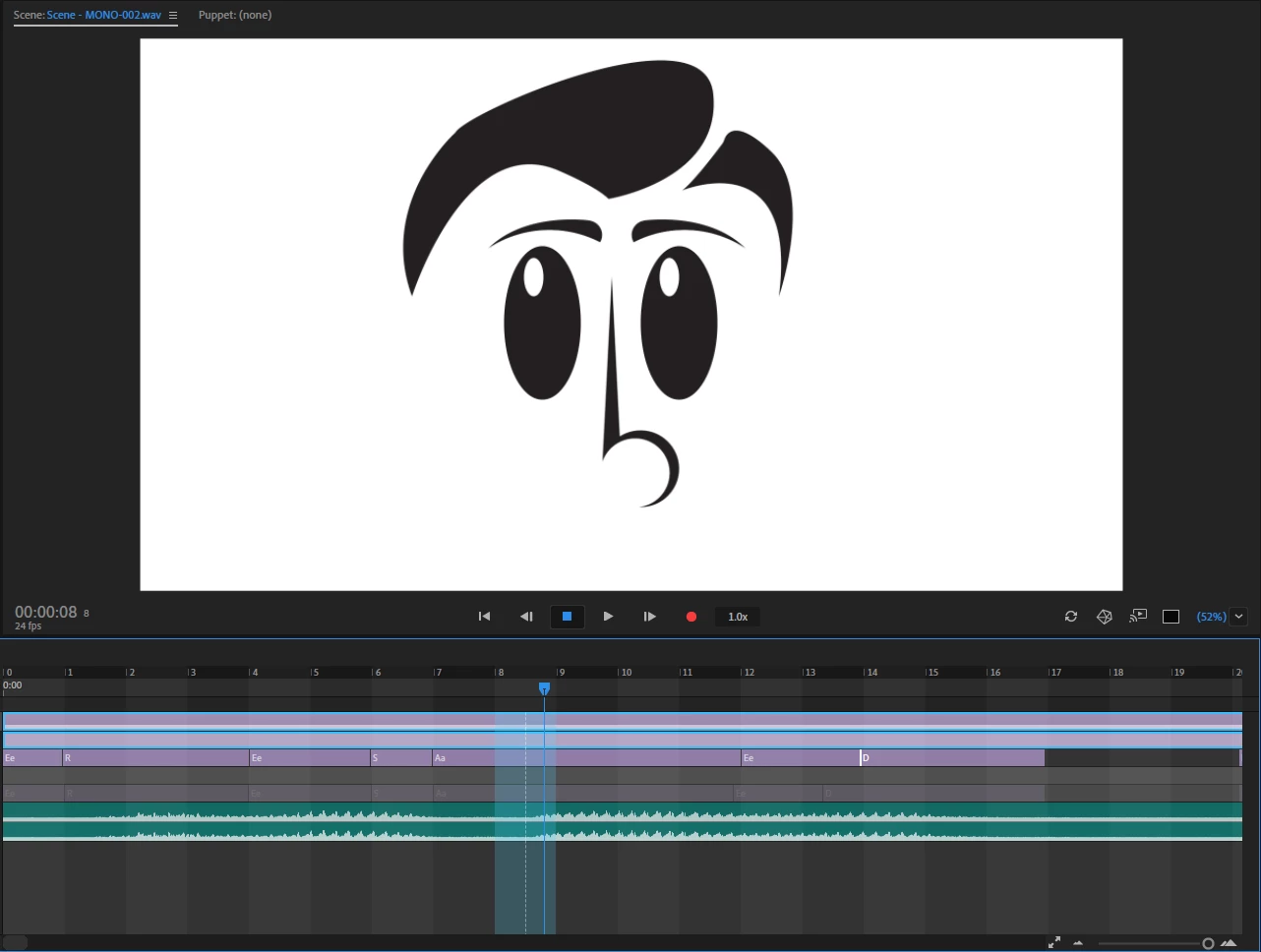

    That last screenshot, the cursor was not on the last frame of the sequence. Could you shows a few consecutive frames showing mouth appearing and disappearing?
    Oh, and do you have profiles or anything else unusual? Starting to wonder if its not the visemes, but rather something else in the puppet switching something causing the mouth to disappear. To test that, if you stretch and slide the visemes around manuall, keeping the blue playhead on the same frame, does the mouth appear? Then if you pick a position where the mouth is visible and drag things around there again, does it disappear? If no change, that would be stronger evidence its something other than the mouth getting in the way.

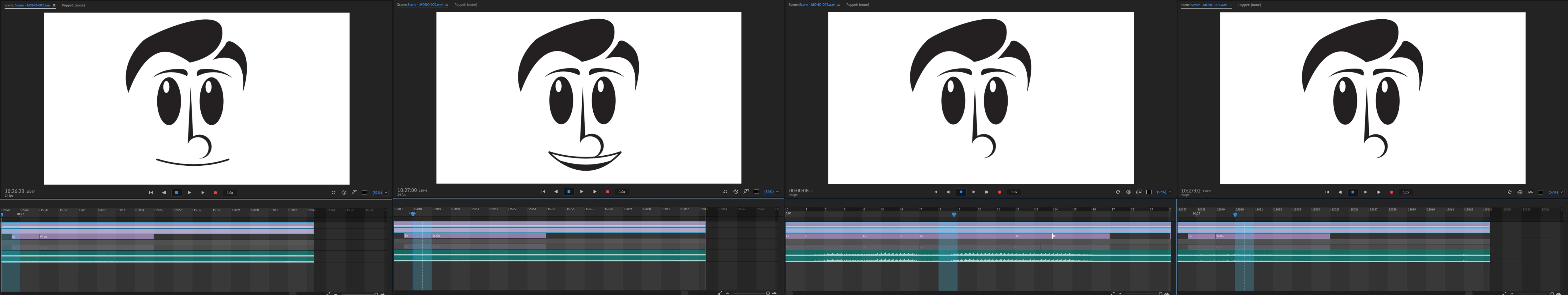

    Here are some shots of the frame timeline near the end of the scene:
    Hope these help! See my reply to Dan for the Rigging breakdown.
    - James

    jamesf16266414
    Mar 28, 2019 7:47 PM UTC
    Thank you for the advice,
    I didn't manually change the frame rate - could it be related to the audio file I'm using?
    I dragged a few of the visemes into new positions at the frame divides and then recomputed the lip sync, but it just put them back to their original positions. I tried re-aligning some of them manually and replaying the video, just to see if it would fix it, but it doesn't seem to have: picture attached.
    Let me know if you have any more thoughts,
    James

    Mar 28, 2019 9:24 PM UTC
    The lip sync engine actually operates at 80hz so its outputs are not necessarily aligned to frame boundaries. For some framerates, it's even possible for it to generate a viseme in an interframe gap that is never displayed. The lip sync behavior just takes the value that's active at the middle of the frame.
    We've considered whether we might get better results in some cases by informing it of the target rate, but haven't done those experiments yet.
    All that is to say that I don't think the misaligned visemes is the key part.
    I'd be curious to see the puppet's mouth rigging. Visemes being mutually exclusive, it seems more likely that one of them is a cycle layers animation (like what Alan asked about above) that is finishing and running out frames (instead of being set to hold on last layer) or a mistagged item causing one of the mouth shapes to be missing.
    If you look at the properties panel for the lipsync behavior on the puppet, there's a section that lists which layers matched for each viseme. Maybe that will provide clues as to what is wrong?
    DT

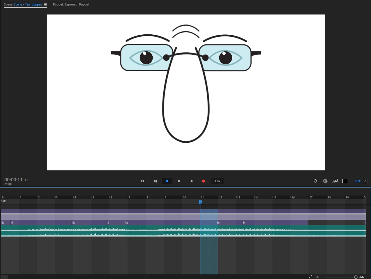

    Could you zoom in on the timeline and screen grab the visemes that compute from  lipsync generated? The zoom control is in the bottom right corner (slider between two pictures of mountains or something). Can you move the playhead to the position where the frame disappears - is there a viseme there for that frame? If you can screenshot that and paste it here in the forums that would be great.
    My guess is a viseme is broken (not tagged correctly - e.g. spelling error in name) so when that viseme is displayed nothing shows up. But if that is the case, you should be able to zoom in on the frame where everything disappears and see the viseme name that is broken.

    Mar 28, 2019 1:10 PM UTC
    Hi Alan, thanks for getting in touch.
    Here's a screenshot of the kind of thing I'm talking about:
    Let me know if that helps or what you can make of it. Thanks in advance!
