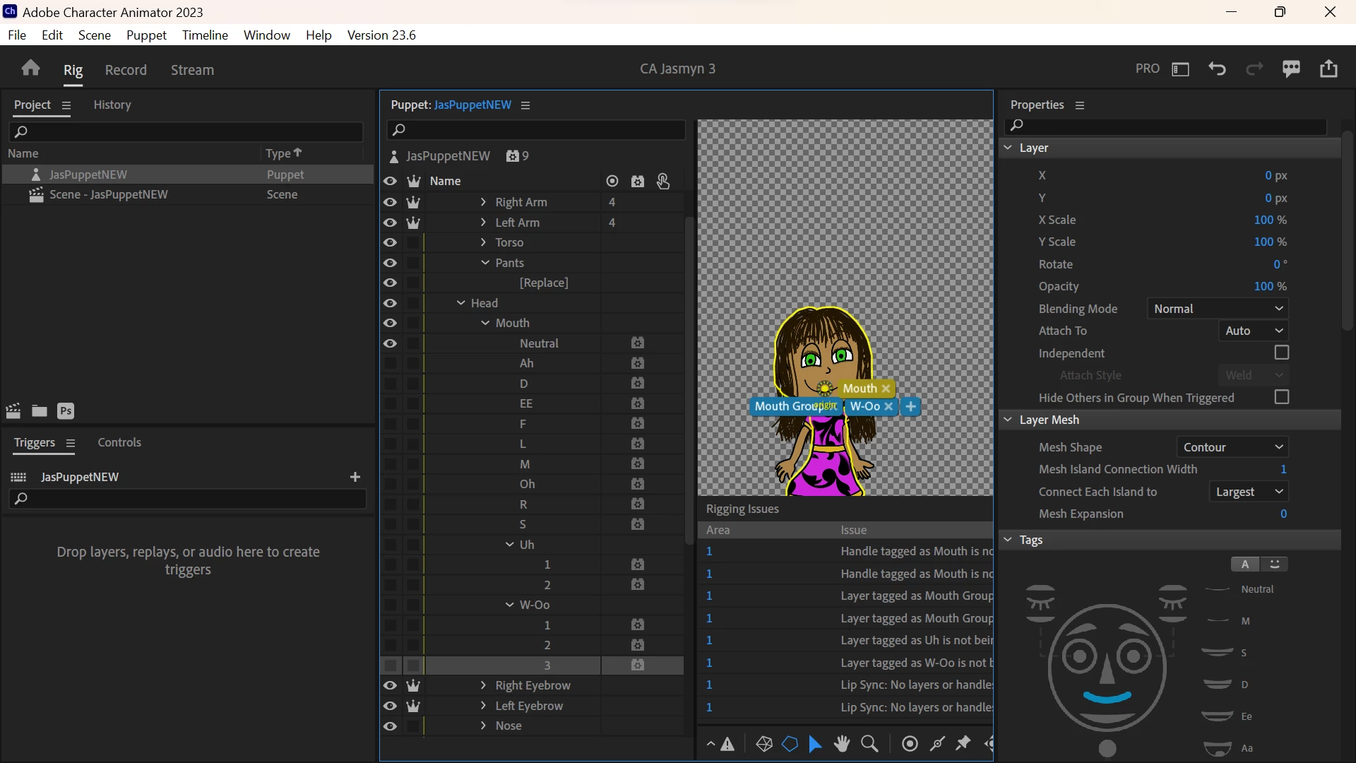

Is anything else disappearing at the same time, like an eyelid? Would it be possible to see a screenshot of the rigging and hierarchy for your head?
Aug 21, 2023 10:29 PM UTC
Just the mouth, everything else appears to be working properly. Here you go:
TheOriginalGC
Aug 22, 2023 12:58 PM UTC
I'm trying to figure out what behaviors you have attached to the mouth parts. It's normal to have cycle layers on there, but not when there's only a single layer. Is there something else attached?
