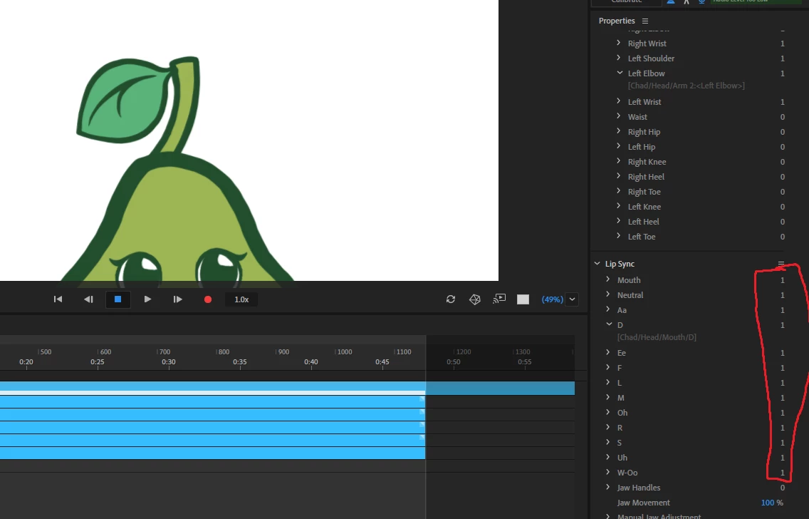

I'm having this issue where the it's the smile / surprised / neutral mouths are the only ones that move. But it's only picking up my silent mouth movements vs when I'm actually talking. I have more mouths but only those 3 are showing up.
Was wondering if someone could help? I'm also unable to post my puppet/ PSD file here. It says it's not the proper file type. Would appreciate the help!
Jan 24, 2022 3:18 AM UTC
I can upload this screenshot though. They all have a 1 by them which according to the video I watched means that they should work/sync with my mouth?

The '1's are good. I would check the microphone is working with CH. E.g. CH does not use the default system audio input. If its not picking up your voice, (or the LipSync track is not enabled so not recording), that would be one reason it is not working.
One thing you can do. If you try a recording, do you get a LipSync track? Are there visemes on it with names like "A"? If no Visemes, can you add one (right click on the track)? If you can add one manually and it works during playback, then it sounds like a recording problem. If you add visemes by hand and they are not displayed, then its a different problem.

When I did a recording I am able to get the lip movements but I realize they aren't syncing up to what I'm saying.
Also whenever I talk, the audio in the top right will light up so it is reacting to my voice.
