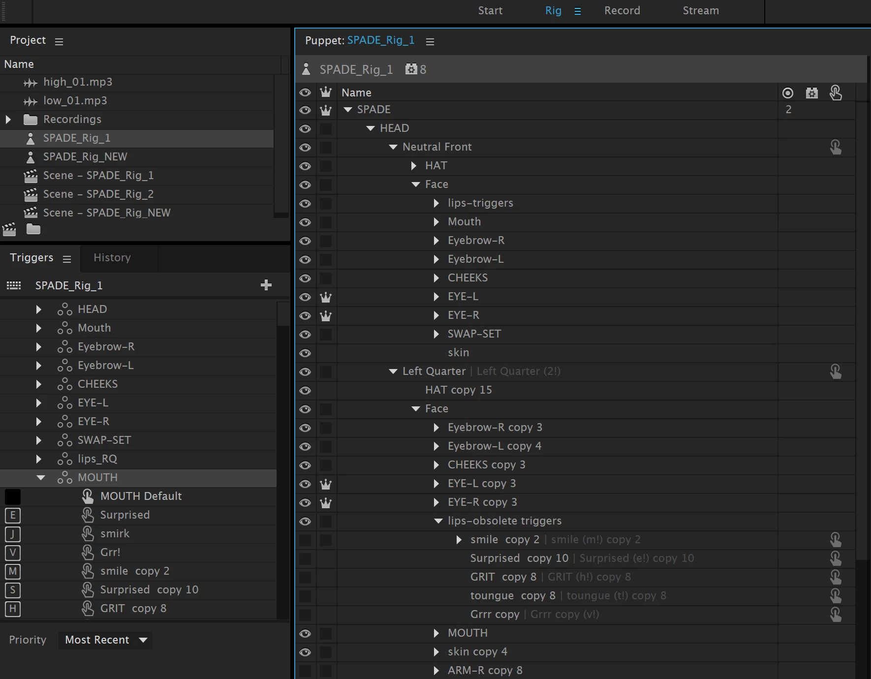

I followed another user's discussion on this, and tried a few things that don't work.
I got it to work very briefly, then it stopped and won't anymore.
At first, the mouth would simply disappear when I hit the trigger key. I added a layer with just the mouth triggers, and it worked for about 5 minutes.
Now it won't recognize any of them at all. It does lip sync and smile and surprise, and that's it. It also recognizes their triggers BUT THAT'S IT!
In the other discussion where someone is having trouble, there is mention of a video (but no link?).
I have searched the tips and tricks and can't find anything that might fix this!!
I did try importing the mouth as its own layer in the swap set. [Following these directions: Character Animator New Features (Part 1: Triggers & Controls Panel) - YouTube ]
And also giving the triggers their own layer which didn't work at all.
What is going on?

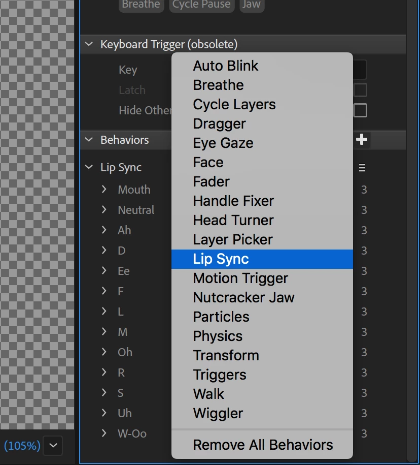

I was having the same issue. The default mouth worked fine, but the alternate mouths wouldn't do anything other than the Neutral position when triggered. With the topmost mouth folder selected, I added the "Lip Sync" behavior in the bottom right panel of Rig mode. It seemed to fix the issue for me. Hopefully it works for you as well.

The pattern I follow is to have a "Mouth Group" (not sure that is the right name, but whatever) with all the mouth triggers in it. Then also in that group is the "Mouth" layer. So the triggers when fired hide the siblings (including the "Mouth" layer with the lip sync alternatives).  Your hierarchy seems to have the mouth group outside the trigger group, meaning when a trigger fires it won't hide the normal mouth (hence you see two mouths).
Here is the pattern I follow now. "Mouth Group" with triggered different expressions, with "Mouth" one of those choices.  "Neutral", "Smile" etc are inside the "Mouth".

Okay, thank you! I will try that.
