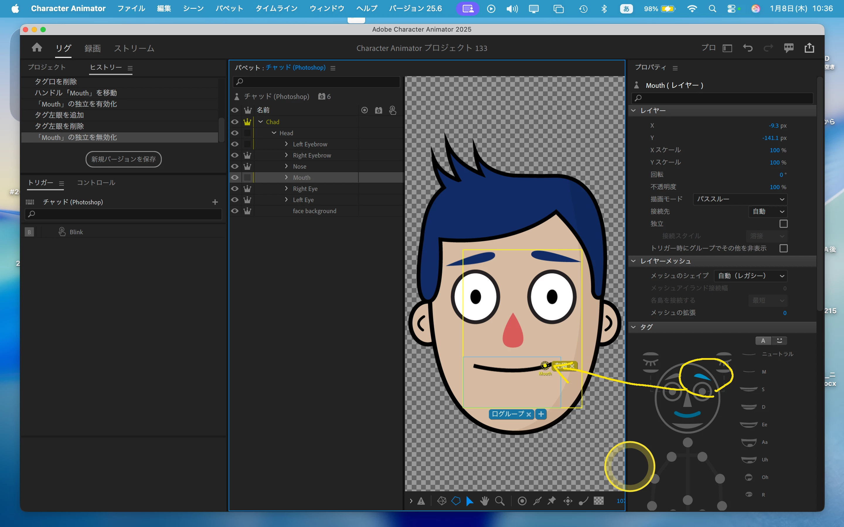

Hello! I'm having a great time with CA. I've got a puppet rigged with head turner behavior, and when the character looks up, the mouth moves to the side and turns strangely. This only happens when the 'Face' behavior is record-armed. Posting a pic for reference.
It's probably a really simple solution, but I'm coming up blank! Any help would be so appreciated. Thank you!

There could be several reasons for this.
If possible, please export and share your puppet. I'll take a closer look.
Common examples include:
1) The mouth Group Layer lacks an independent crown mark, causing the mouth to move due to being pulled by other actions.
2) The mouth Group Layer has an additional eyebrow tag.
For your reference. Thank you.
