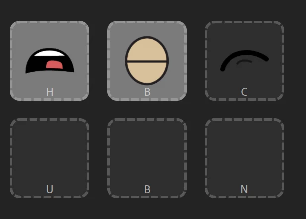

I am wondering if anybody could help me, please… I am making a character of my son by modifying the ‘Chloe' puppet and importing a lot of graphics from the ‘Tull’ puppet… I am nearly done and am just finishing the rigging stage but for some reason when I trigger a different mouth trigger the mouth I am triggering disappears. It's been working no probs for the last few days and only started disappearing this morning and have been wrecking my head as to why.
Also… and again this was working… when I move a new trigger into the controls panel the visual graphic icon does not appear. See bottom 3.

The short answer is that your "singles" group has the eyeball off, so the triggers inside it are being turned on and off, but the container is always invisible.
As for the missing icons for those other triggers, those are Replays referencing Dragger animations, so if you want an icon, you'll need to create it yourself. To do that, you need to add your icon to your puppet somewhere(it can be anywhere). Then you can drag it onto your Controls panel trigger when you're in Layout mode.

creativegoodman
Apr 2, 2020 9:05 PM UTC
Daniel... thank you so, so much for this... you are 100% right on both accounts! Day made 🙂 Thanks so much again.
