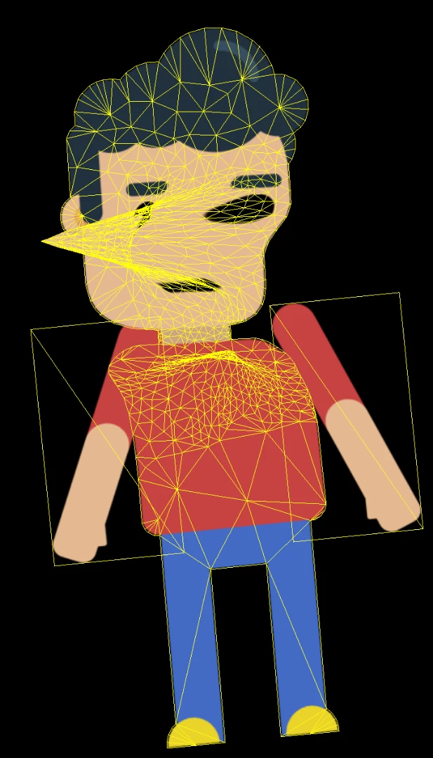

I've created this simple background character using a template from a more complex character, so the set up is almost identical, but when I move this characters head by clicking on it, the mouth doesn't want to move as if it's pinned and it warps the head. I've tried deleting every layer of the mouth, but it still warps. The only that has worked is deleting the mouth layer itself.
My almost identical character doesn't have this issue and I have spent hours trying to figure it out. I've searched the forums for answers, but couldn't find anything. Thank you to whoever checks this out. Here is the adobe ai file: Dropbox - Character- Eric.ai

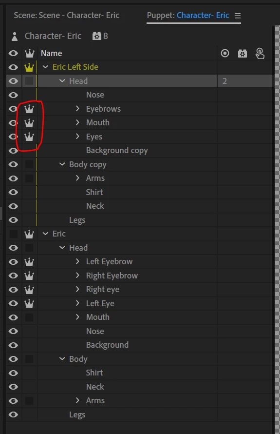

To solve the problem, you make those groups independent (each eye, eyebrows, and mouth). You click on the crown, or use a "+" at the start of the layer name. Then the Face / Eye Gaze / Lip Sync etc behavior has full control over that layer, but the layer still moves relative to the parent that it is attached to. That way it does work.

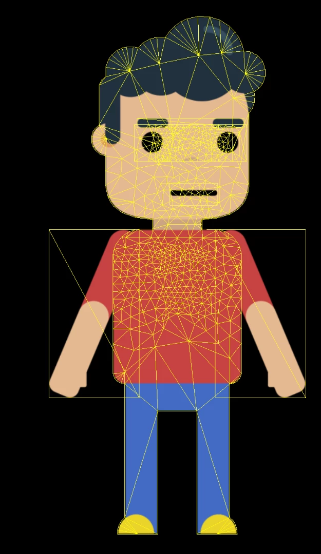

Normal (with mesh on)

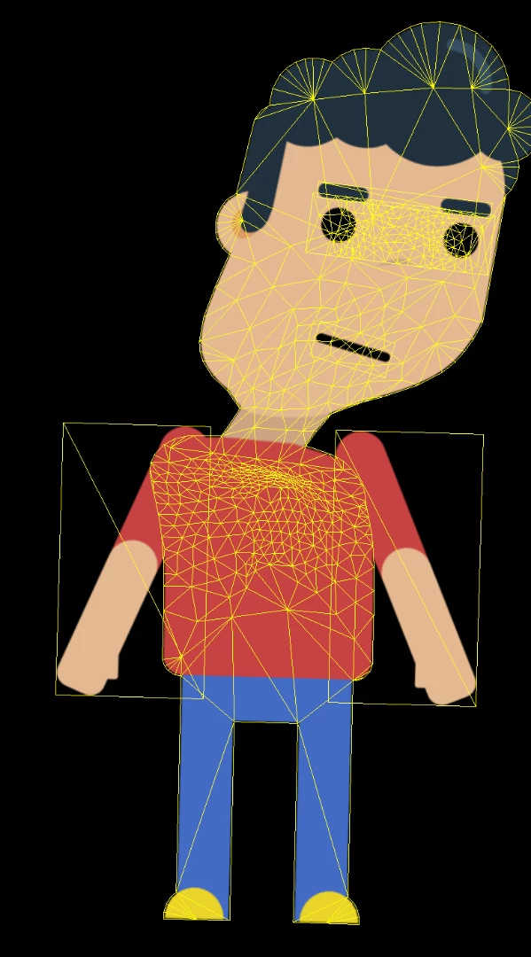

Dragging the head with independence on - better (but mouth still goes on angles)
I just clicked the 3 clowns as follows:
