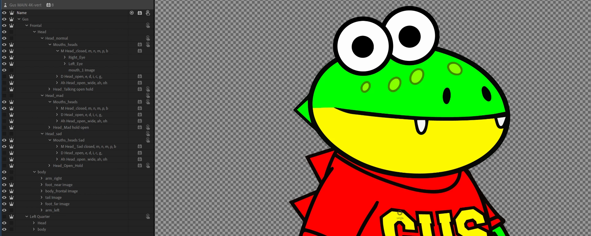

My suggestion is in the lip sync behavior (or was it face) there is a View or Handles section with s little triangle next to it to expand the section. What this will reveal is what layers have been bound to different visemes. I would look to see what layers you expected to get bound to visemes but were not.
The rigging hierarchy is fairly complex. I am wondering if the auto tagging rules where changed, or the scoping code is only picking up one set of visemes and not all of them. If the latter you may need to add a lip sync behavior per profile? Then you might need to make sure you record the right lipsync behavior. But not sure.
Happy to have a play with the puppet if you are willing to share it if you cannot work it out. But certainly this rigging is a bit more interesting than s typical puppet. Not wrong, just different. It might need fiddling with the puppet itself as a result.
Jul 9, 2019 1:07 AM UTC
Under "Head" there are 3 emotions (Normal, sad, mad)
Each emotion has a set of mouth heads for lip syncing, and a set of mouth heads for "holding open" the mouth w/cycle layers trigger.
Under each set of mouth heads are 3 mouth heads (closed, open, wide open), each of which are assigned to various mouth characters (Aa, ee,Oo, etc).
All of this is then applicable to the qtr left turn, which is not being used.

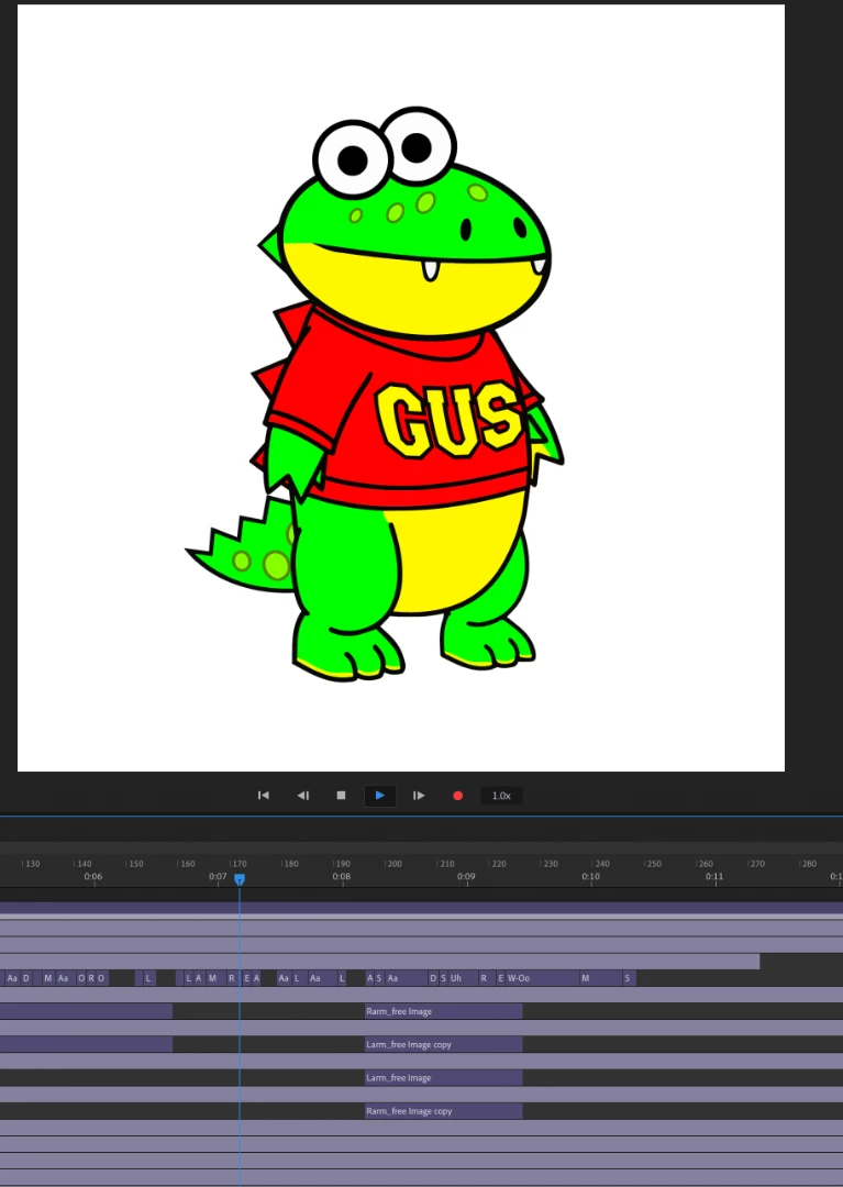

Here's a screenshot I took during playback, where the playhead is clearly over a viseme that should produce and open mouth, but is not.
Aug 13, 2019 12:05 AM UTC
BTW, the screenshot you posted won't show the viseme from the timeline if your puppet is armed and the lipsync behavior is also armed. That's because it needs to be able to respond to the live input. Ideally we'd add some sort of playback vs. rehearsal mode to make this simpler.

I think some of the behaviors have changed in how scoping works. I would find the face behavior and expand the “handles” and “views” sections. This shows what the behavior bound to. My guess is you have multiple profiles but they no longer all link up correctly.
Could you share a screenshot of the rigging hierarchy of the puppet?
