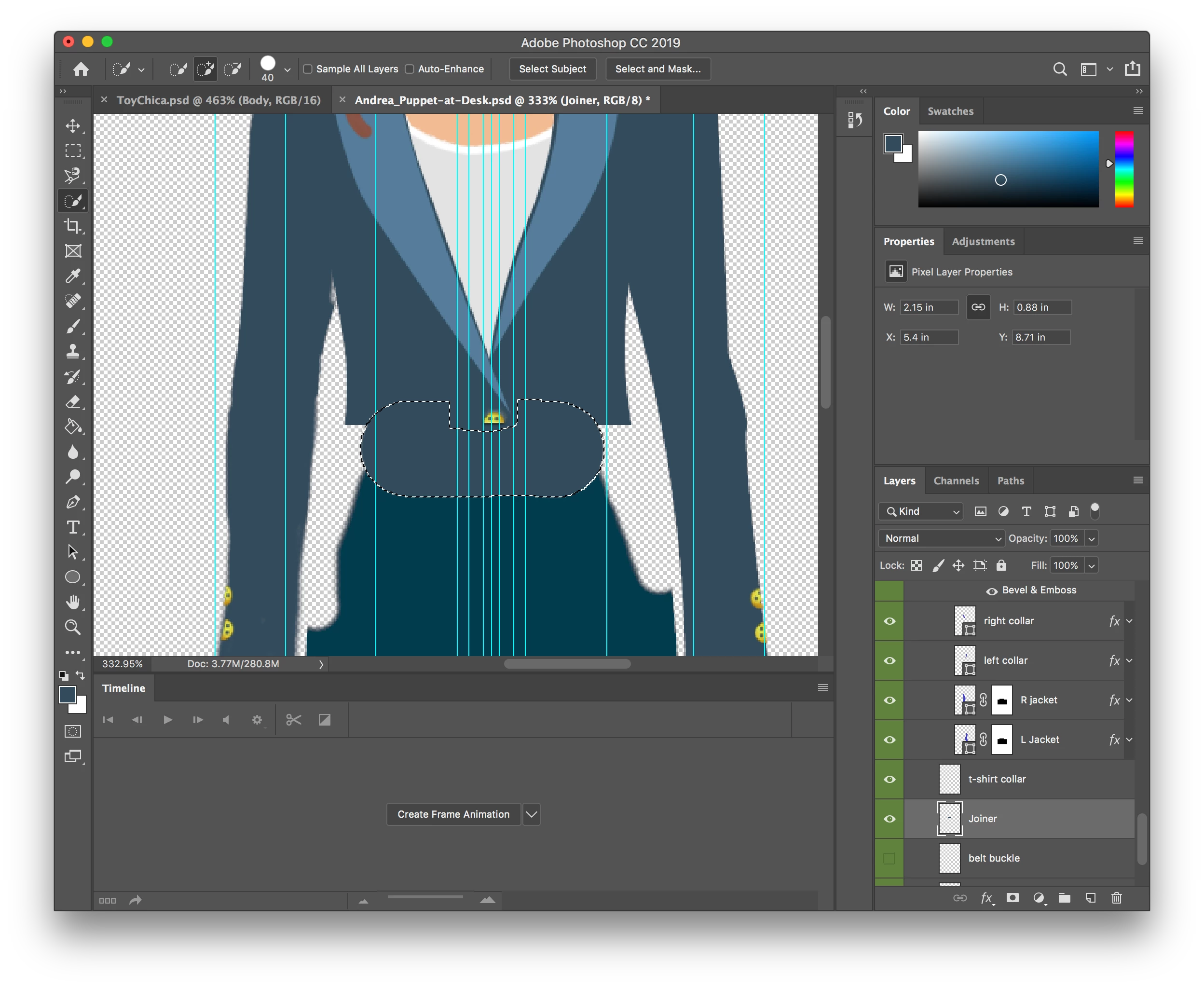

    hi Dan!
    Thanks so much for taking the time to check out my puppet. I was using the mesh and went through and made sure to remove all extra pixels, but thanks for the contour tip.
    I am able to see the mesh that you are talking about, just not sure how I can go about fixing it? I can delete the pants layer for this scene, but can't delete the color for her shirt - would it help if they were in a folder? Or should I make them into a smart object (although then it wouldn't be so easy to edit the file if changes were needed. Also not sure how I can make them touch - expand all the art with filler so things overlap?
    Thanks for helping on this... glad I caught  a bug of sorts, so I might be able to help others decode their issues in the future!
    Thanks again!
    mark
    > ...just not sure how I can go about fixing it?
    One option is to delete the pants, belt, and belt buckle. Also, since the right arm is warp independent, the right arm on desk probabably can be as well. After I make those changes, the torso and head are a single mesh which uses contour by default.
    > ...expand all the art with filler so things overlap?
    This would be another option. Even with all the layers showing, I see a gap between the pants and the bottom edge of the jacket. By adding a new layer and painting in enough pixels to touch both layers, the mesh becomes contiguous. That layer, like the pants, can be hidden and it'll still work. If the right arm on desk layer is also warp independent, the mesh contours naturally around the head, torso, and legs.
    Then position the head handle to get the rotation point that feels natural, and I think it'll work better than before.

    Thanks for posting the puppet. This is a job for mesh visualization, as it turns out.
    If you click the Show Mesh button in the lower left corner of the puppet panel and select one of the layers/groups that are part of the head/torso mesh, you'll see a very large rectangle of mesh. There are several "islands" that are part of the same mesh: Pants (even though it has its visibility disabled), Belt, belt buckle, and Right Arm on Desk are also part of the meshing group that includes Head, Body/upper chest, Body/Jacket, Body/T-shirt, and Body/t-shirt collar.
    These do not form a contiguous region of pixels, so the mesh falls back to using a large rectangle filling the whole area. If you also turn on Show Mesh in the scene panel, you can see how the larger rectangle moves in response to face movements.
    When I removed some of the non-contiguous parts and moved the head handle up a bit so the rotation , I was able to get movement that was more localized to the head and neck. This could also be accomplished by filling in the gaps so that these layers that are meshed together are connected.
    If the reason for the rectangular mesh had been due to smaller accidental patches of pixels (a stray brush stroke, for example) it is also possible to change the Layer Mesh option from Auto to Contour, but in this case that does not work since it chooses the Pants layer (since it is the largest area, I think) and the other "islands" (the face and torso parts) disappear.
    DT
    P.S. This is a common enough problem that it is on our list to provide some better handling of multi-island meshes. The rectangular fallback almost always behaves badly.
