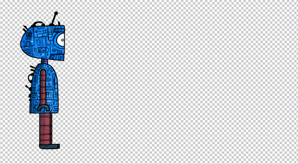

    rooniboy
    rooniboyAuthor
    Mar 28, 2018 5:56 PM UTC
    Thank you for your response.
    So here is what i did your suggestion. I added the walk behavior to my character and then recorded him running and It looked great. Then, at the stop frame, i edited my character to add draggers to its feet. I recorded him kicking the ball, and it looked good. But when i play the whole recording, it messes up the feet. Feet looks like they are sticking to the ground.
    Here is what it looks like. Its my first time exporting a GIF, so please bear with me.

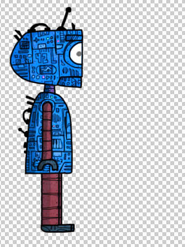

    KJerryK
    Mar 28, 2018 9:13 PM UTC
    In my example, I just used the fully rigged Walkbot puppet available in the start screen, and added a draggable tag to the middle of the right foot. So you could look at that and compare it with the rigging on your puppet to see if there are any differences.
    I did try to replicate your problem, and here's what I got when the legs are not crowned. So you might check on that.
