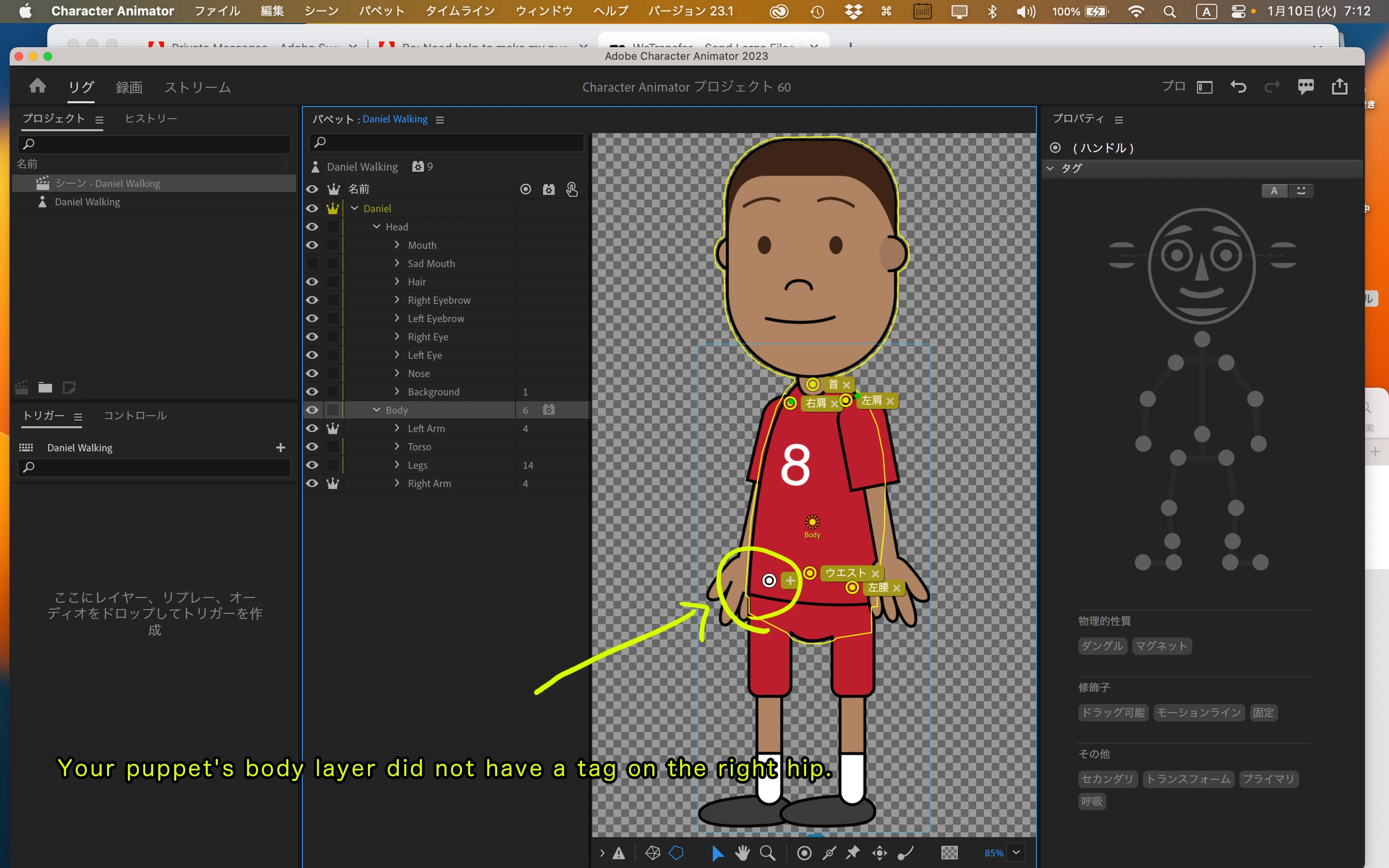

1) Your puppet's body layer did not have a tag on the right hip.
2) You do not need to tag the layers that group the feet together.
3) Added toe tags to each foot layer.

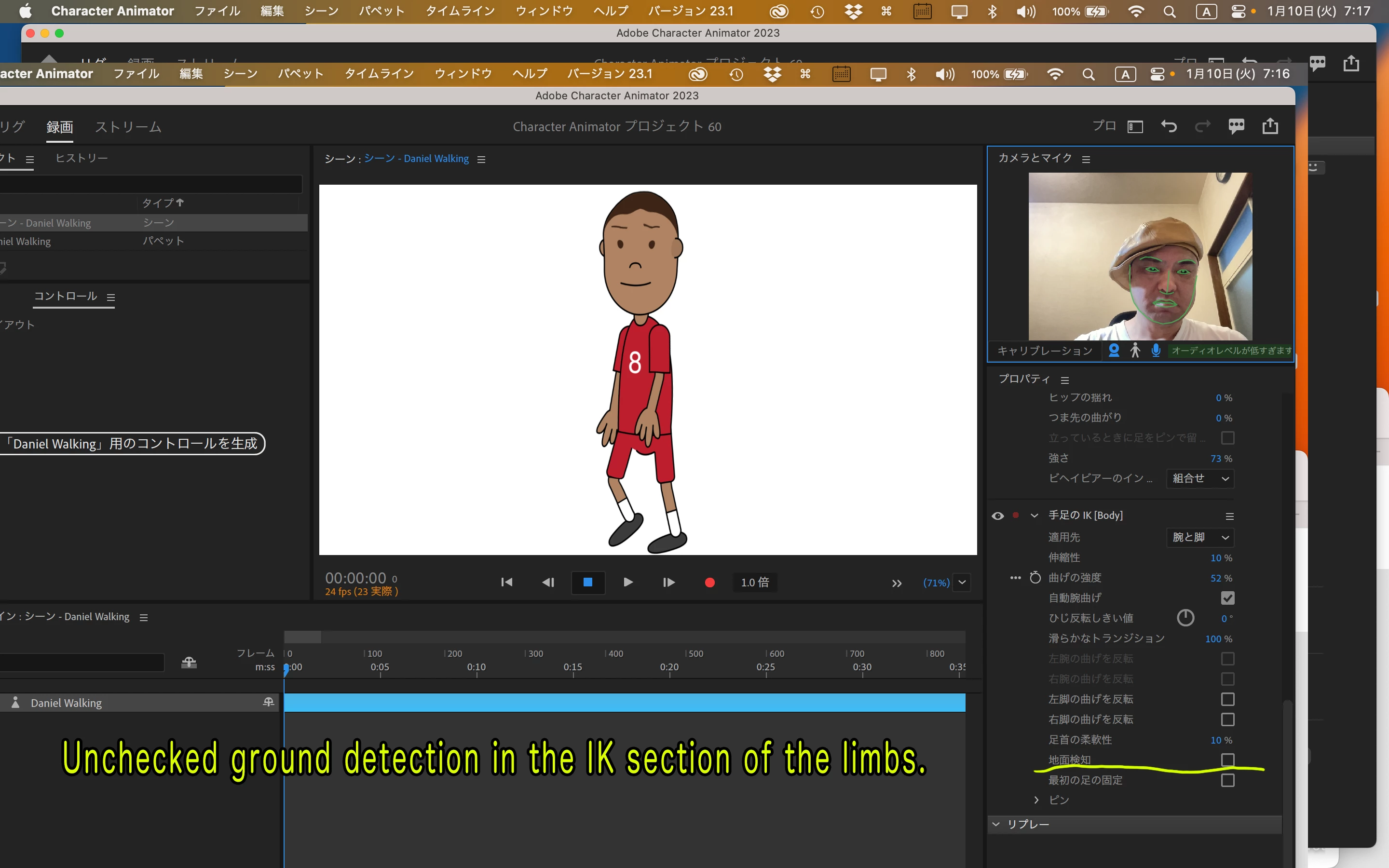

4) Unchecked ground detection in the IK section of the limbs.
Please check.
Please check.
