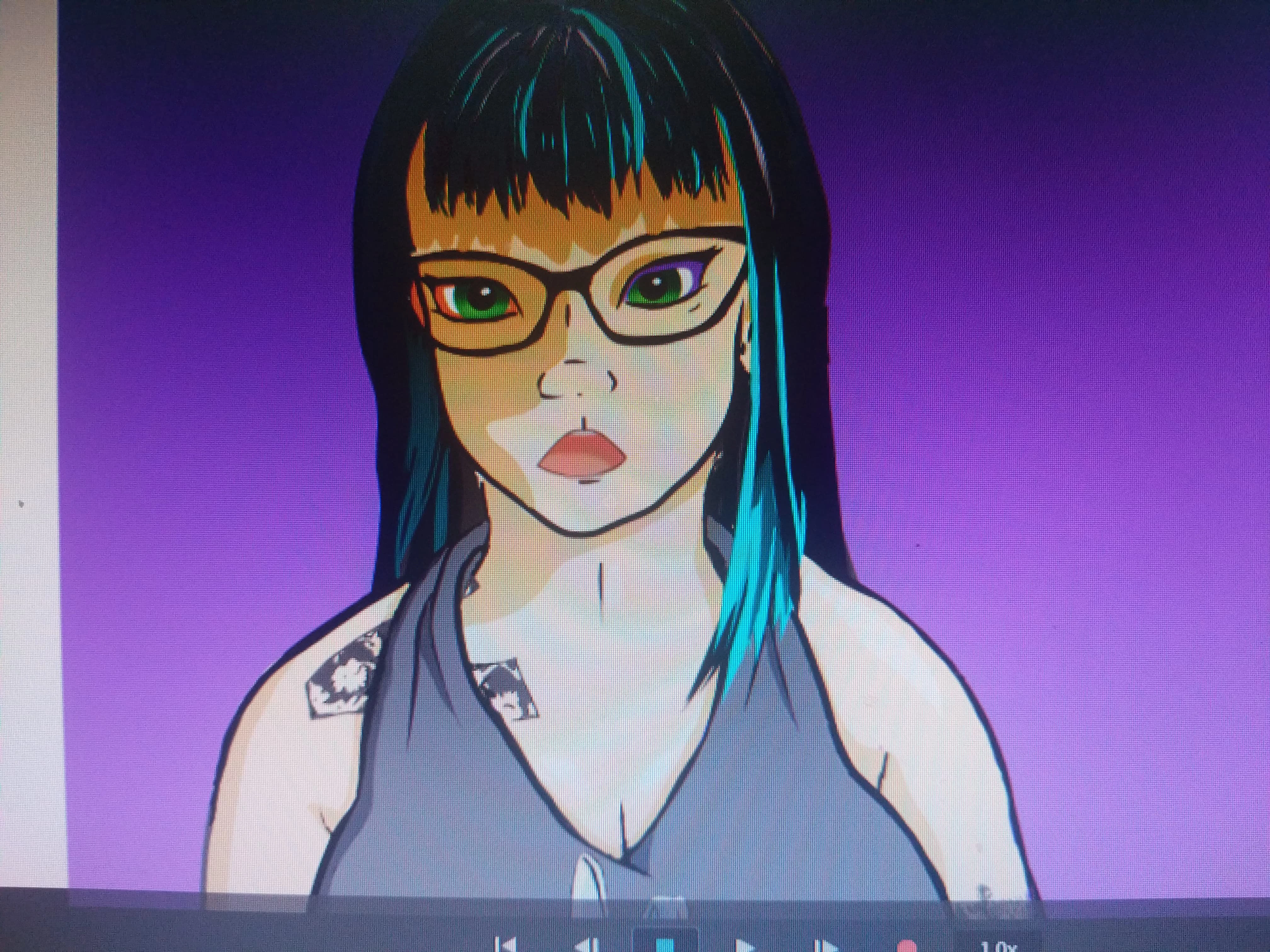

In the Face behavior, there is a "Head Scale Strength". A workaround is to set that to zero, then moving your head closer or further from camera will not scale anything. The idea is to expand head when leaning forwards, but it seems like *some* of the head is scaling and the rest is not!

When you pull your head away, does it look like the eyes are getting smaller but the rest of the head is not? Would that explain the third photo?

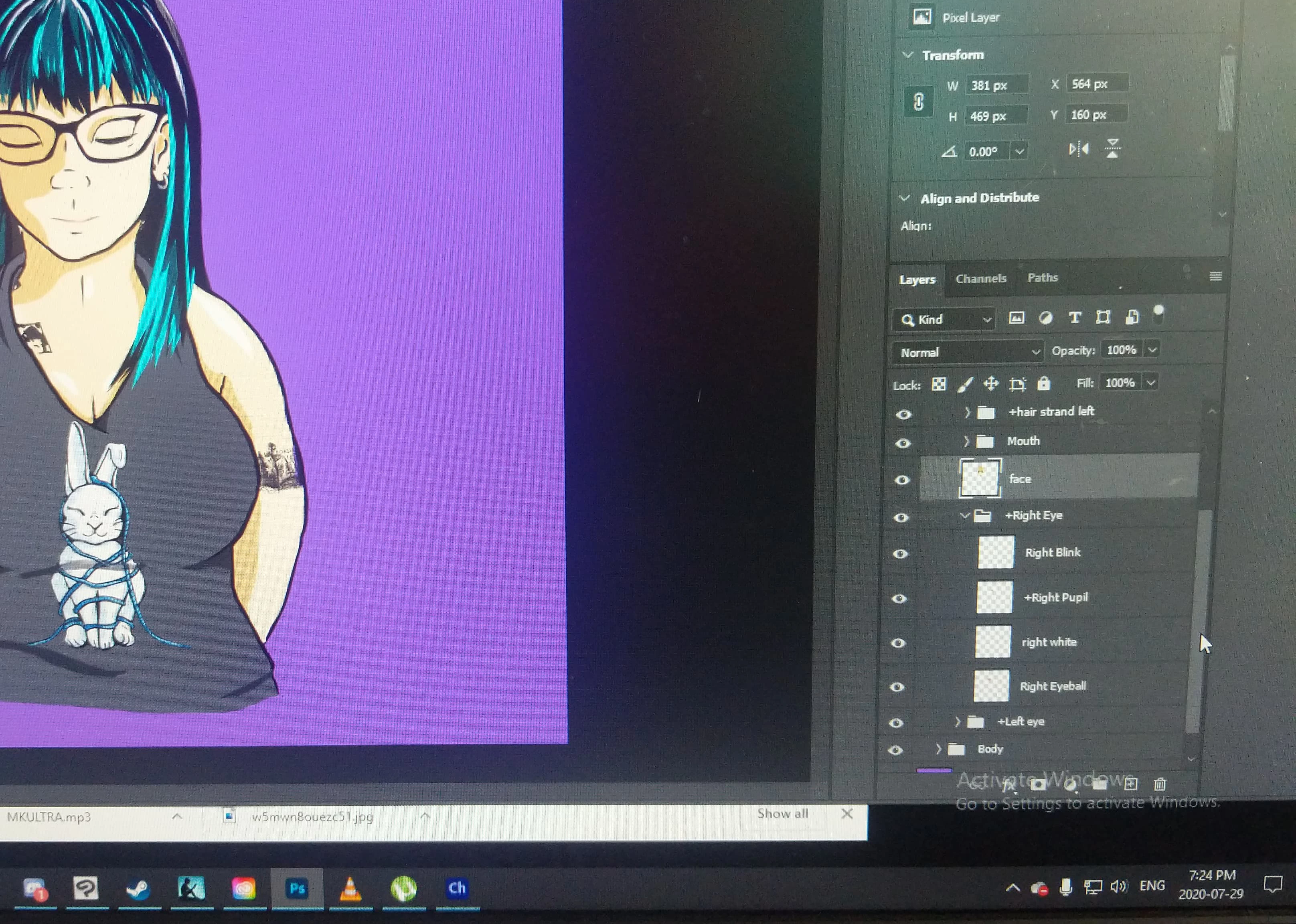

What can be useful is a screenshot of the rig hierarchy in CH. Go into rigging mode and screenshot that hierarchy. It shows independence layers as well. But read the blog first - maybe you can work it out yourself.
The other thing I would suggest is looking at things like the Face behavior and expanding the Handles section. Does it reference the layers you expect? A screenshot of the handles can be useful. For example, I am wondering if "Head" is not binding to the head layer, but rather some nested layer. That might then move the eyes but not the whole face. or there is some independence that is messed up. The PSD file looks fine on the surface however.

Here is the tree for one of the eyes in PS.

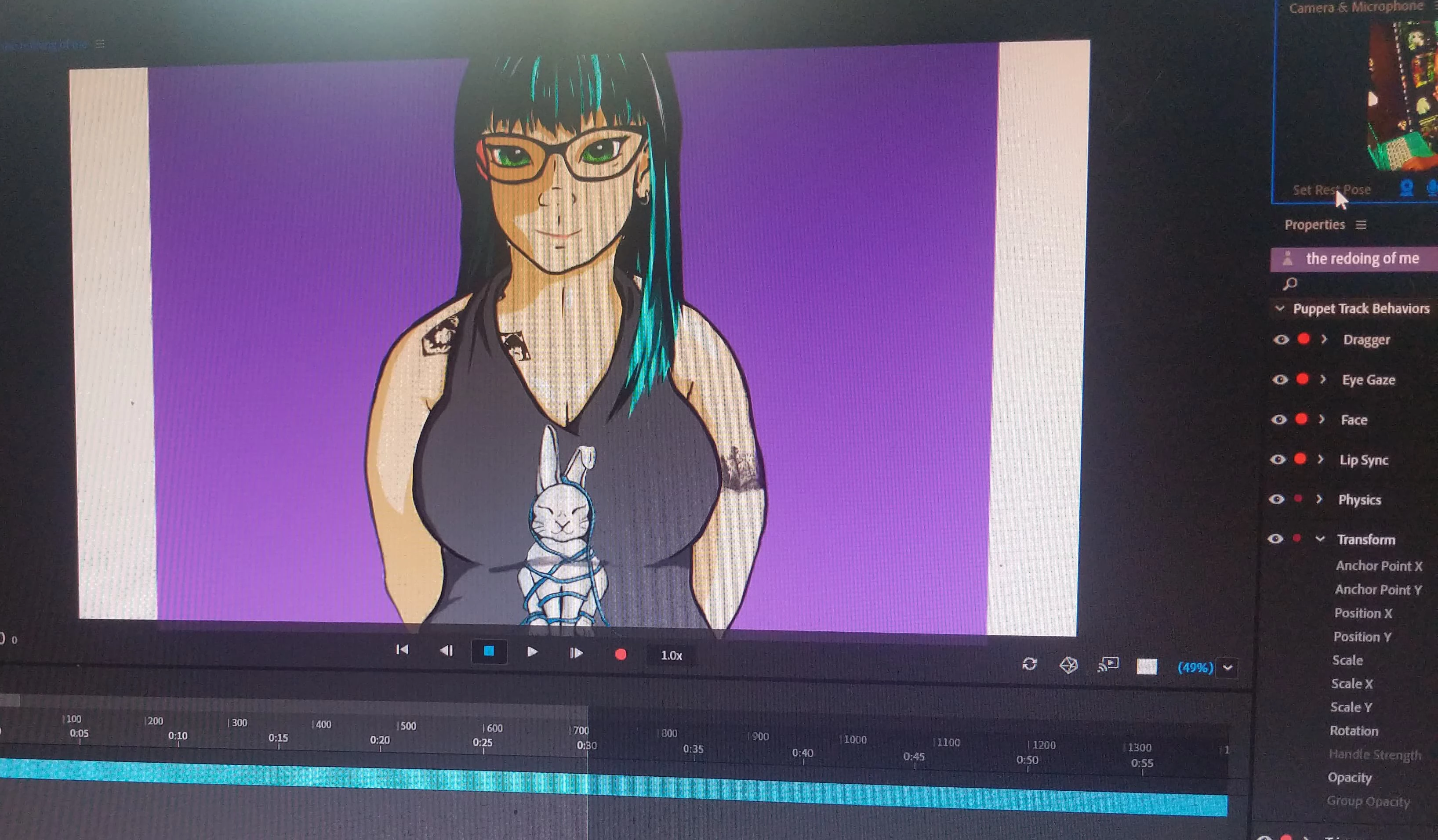

Here is the puppet looking 'normal'
Here is what happens to the eyes if I pull back.
