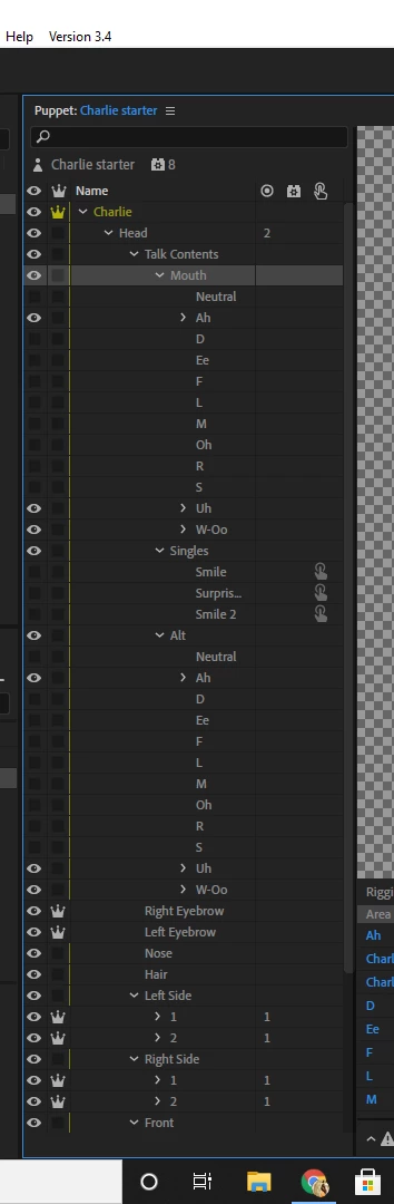

Neutral mouth showing up over triggered mouths
Playing with my original toon and adding more stuff to him. He's looking really good except for his default mouth is showing up over his other mouths when I trigger them. I'm using the same set up as the "Dave" puppet. Below is the set up. My triggers work great I just can not figure out why the neutral mouth want go away when I trigger the other mouth sets.

Do you have a swap set defined to hide the default mouth when you trigger the alt mouth?

Feb 5, 2021 5:50 PM UTC
Fixed the problem. I needed to simply tag the Alt mouth set as a mouth and now all works good.
Another thread you had replyed to helped me fix the issue. Thank you.

Let us see the hierarchy for your mouth layers and we'll try to fix it.

I haven't even started working on the Alt mouth set yet. Right now my problem is with the Singles. My triggers work but the default mouth shows up over top of them. But I will probably have to do that when I start working on my Alt mouth set. I'm not sure how to do that though. I'll have to find a multi mouth set how to video.

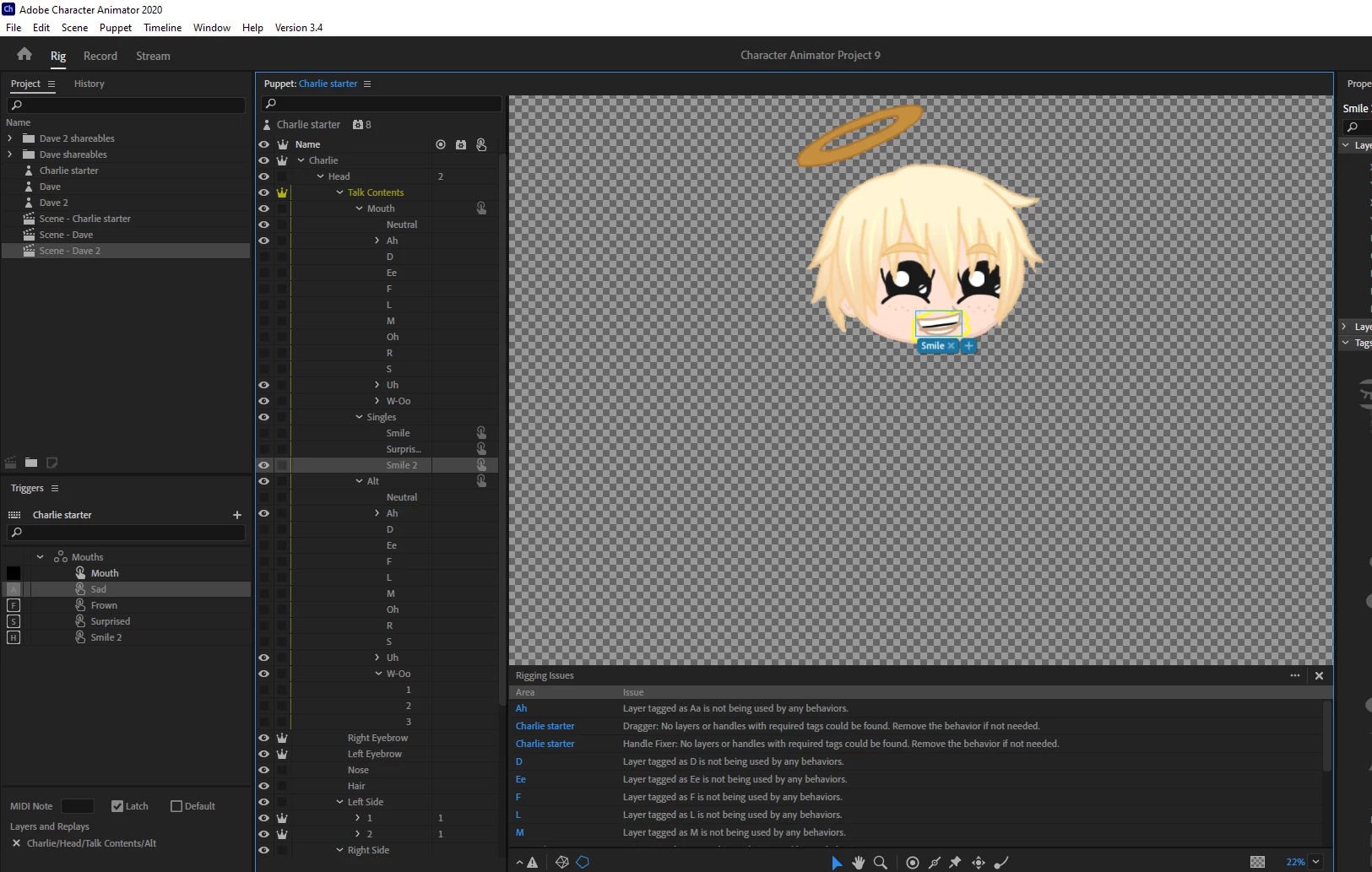

Okay, I think I got what your talking about. I have to do all the mouths at once and not in pieces. Now my singles work I just can not get it to switch over to the Alt mouth set when I hit the trigger for that set the mouth just disappears altogether. Here is the currect rigging and trigger set up.
