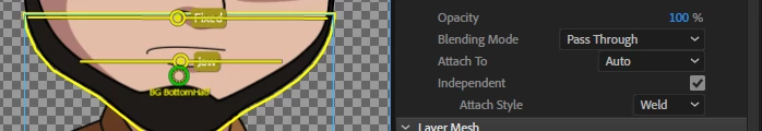

Nutcracker Jaw offset on head rotation
Hi all,
I have duplicated the bottom half of my characters head to apply a nutcracker jaw behaviour as shown in Dave's example with Almasol (here), but when the head rotates (or scales) the jaw layer becomes offset (see image). I have tried changing the 'Attach To' to 'Front Profile', I have tried deleting and redrawing the sticks in different positions, etc. I can't figure out what i'm doing wrong. Any idea how to fix it?
Thank you!

Hello, the first thing I would do is not have the head background and the bottom half grouped. Just keep them as children of the main head just like your eyes, eyelids and eyebrows. As long as the bottom half is in front of the background of the head you'll be fine. Then in character animator select jaw so you can see its properties as shown in the right hand side of the second image you posted, and where it says "attach to" (auto) change that to head or what ever your head group is called should be an option and select that then you should not have that problem.

alank99101739
Apr 11, 2018 8:15 PM UTC
Random idea - have you tried the various Head strength and parallax properties under “face”?
MohammedAli
Apr 12, 2018 1:02 AM UTC
Yep, but as expected it didn't really help much. I even tried to tag the bottom half as a 'Face' layer. Right now i'm getting away with it by not tilting or moving my head as much so it's not very noticable, but would like to find a solution.
alank99101739
Apr 13, 2018 4:06 AM UTC
Another random idea - have you tried changing the origin (move the green circle right up to the top). You mentioned tilting the head was causing problems - maybe because they are rotating/scaling with different centroids? Try making both having the same origin position and see if that helps?
