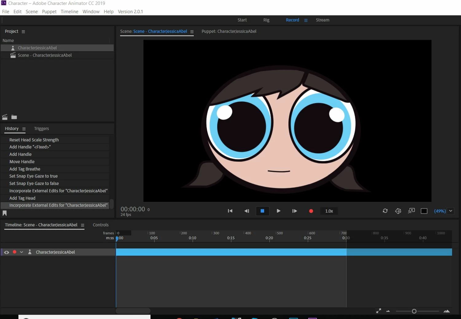

Only Puppets head is visible in "Record" mode.
Hi there,

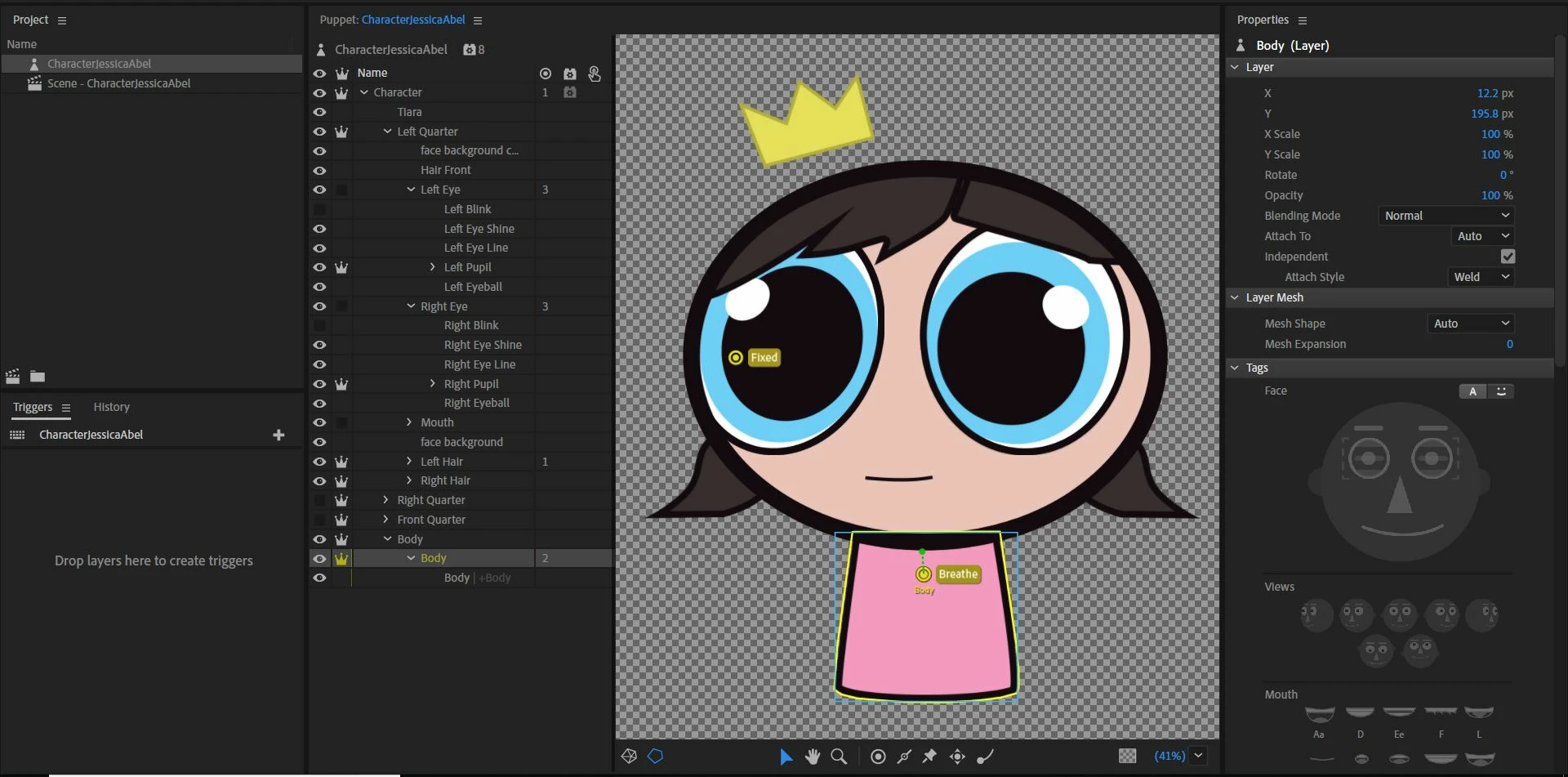

I'm new to Character Animator [I'm only using it for a university task], and for some reason my puppets body and crown I created won't show up in Record mode but are visible in Rig mode. I checked they're both actually turned on with the eye symbol but that doesn't seem to be the issue.
Any help?
Thanks in advanced!

Check the tags. CH automatically creates tags from layer names during imports, but its the tag that behaviors uses to identify purpose, not the layer name. So renaming a layer will normally work, but not always.
You can export a puppet using “Export Puppet” from the menu then upload to google drive or similar and share a link if you want someone else to have a look. its generally pretty simple, but can be tricky to find.
Jan 2, 2019 9:34 PM UTC
I think I fixed it? I moved the "Body" Folder in with the "Frontal" group and it seems to have resolved itself- but thank you so much for your help regardless!

I don’t see a Frontal profile? So when the puppet is facing front (the default) the other profiles are hidden and the head is hidden. I think you can just add a Frontal tag onto one of the other profiles that you consider to be the front and it will start working.
Jan 2, 2019 7:17 PM UTC
Just now noticing that I named the layer "Front Quarter" instead of Frontal- this may help;  I shall change it and see if that changes anything! Thank's for the help.
