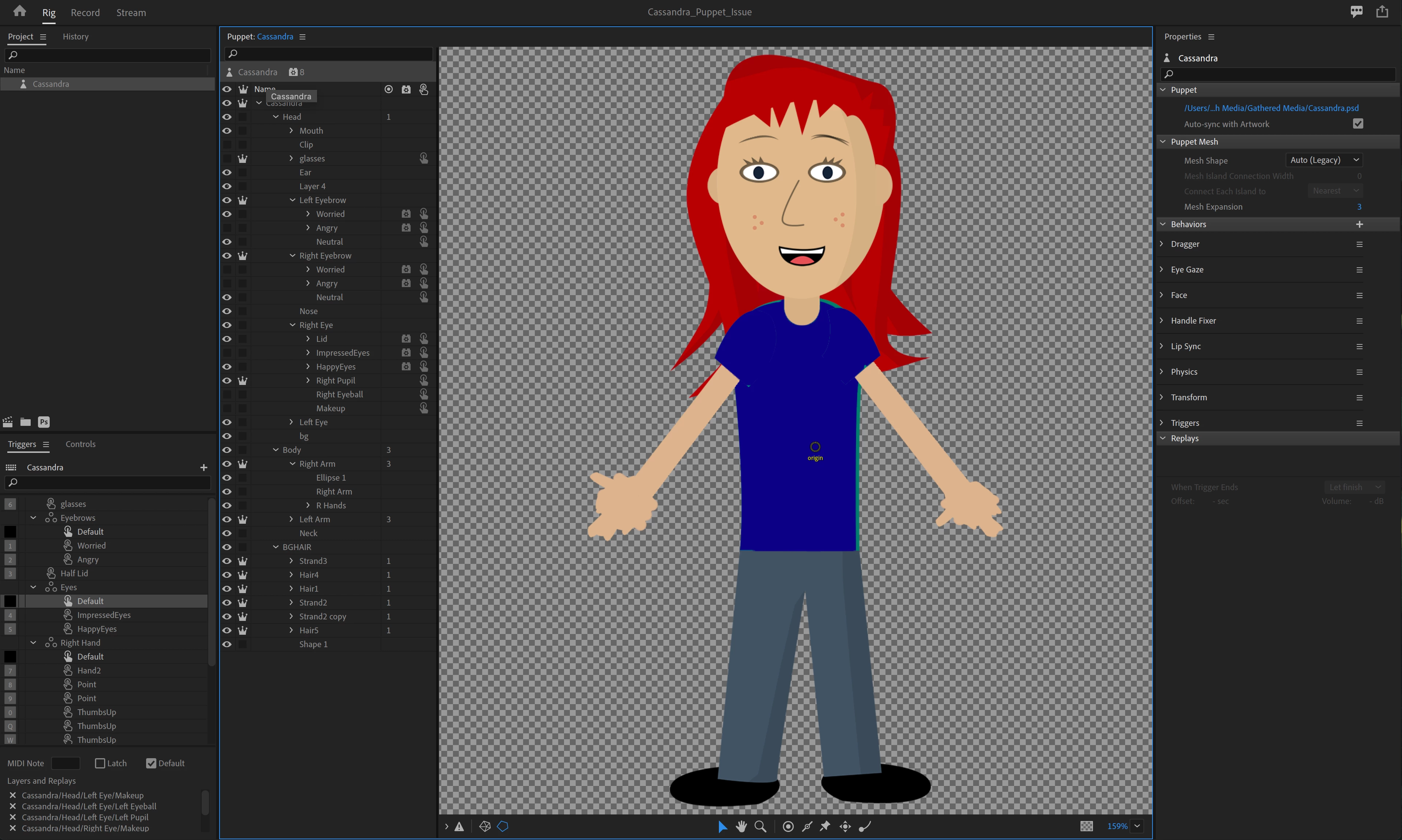

I am adjusting the Cassandra puppet from OK Samurai in Photoshop. When I click Save and return to Character Animator, the puppet has the updated changes showing in Rig Mode. But the Cassandra puppet in Record Mode still shows an earlier version of the puppet. Therefore, I cannot create a scene of my new version of the puppet. I've tried multiple times with no luck. I also tried the following
  • Check that Auto sync with art work and puppet path were accurate
  • Opened CA and PS separately. Changes made in the independently opened PS still only save to Rig Mode in CA
I attached the CA file here. I'd appreciate any expertise in resolving this issue.  My changed version of the puppet should be showing in Rig Mode: eyes aren't open as wide, navy blue shirt, etc.

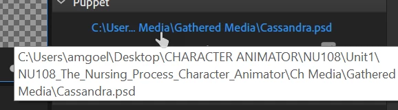

Thank you for the response.
I went in and deleted all the other casandras and there is only one left in one folder: Gathred Media.
I then went into CA and opened the character in PS. I made a change and saved it. I even checked the path in PS and it saved it right to that Gathered media folder.
When I went back into CA, the Rig Mode had the new character, but Record Mode still has the old one. I checked the path in CA, too. (screenshot below)
It's weird.  If I deleted all the other instances of the puppet, where is it reading that old puppet from?  Is there another path in CA that the old version of Casandra is reading from?
You're very kind to keep helping me, though!
Any thoughts now?  I changed out the files in that google drive location with my updated ones if that helps.

I think you actually are seeing the correct file, but triggers are taking over and not showing what you expect. So currently in Rig mode you have frame 2 of the "happy eyes" trigger visible. That's a temporary frame that isn't going to show up (if you press the 5 key in record mode you'll see it in action). You would need to change the layers "Right Eyeball" and "Left Eyeball" to have the visuals come through.
