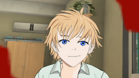

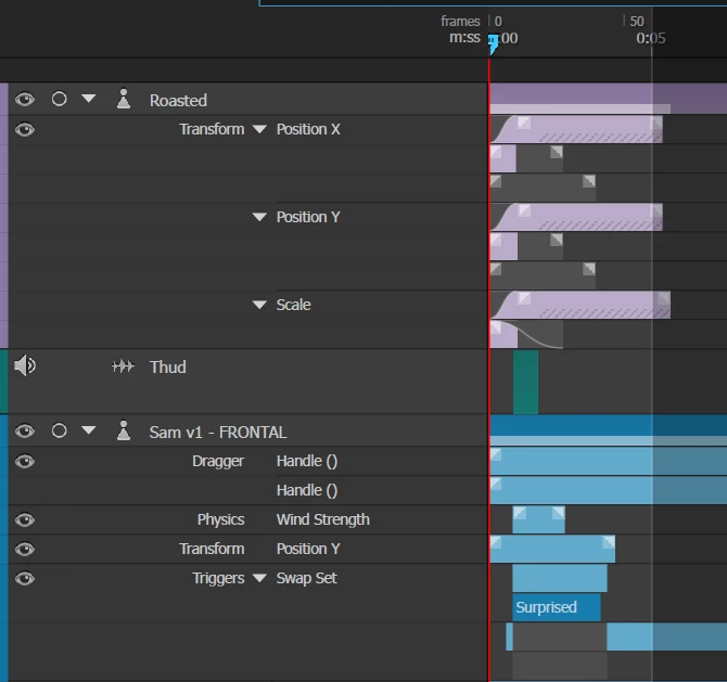

In case useful, here is my timeline for a scene. I caused "wind strength" to go strong for a short bit to cause the hair to blow out. (Don't ask me why my "Roasted" was so complicated - overkill probably. I was trying to tweak so you can see the eyes through the writing as it zoomed in.  "Surprised" was keyboard trigger for the eyes to open up wider.
Here is the final effect (without the "Thud" sound effect). (Hopefully this animated GIF works here...)

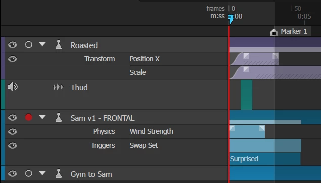

Sorry, I found another scene with a much simpler timeline - probably a better example. The other one was the first one I ever tried, so had lots of mess I never cleaned up. Note this one I used the mouse to spike the wind up and down with the mouse, so the recording looks longer, but its just a quick spike of wind to align with the stamp hitting the face and "thud" sound effect. So in this case it was a true recording. Other times I do a solid wind recording then trim it back. Whatever works.
