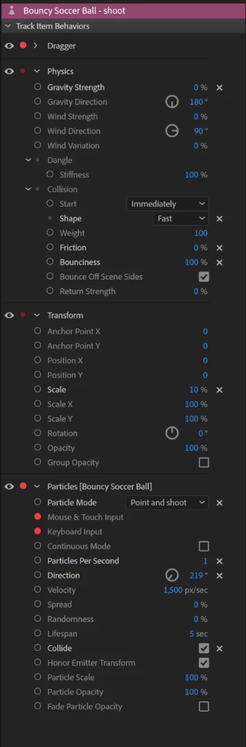

    Probably not useful, but I had a bouncing ball scene where I used the physics behavior, set "Collision"/"Start" to "immediately" (rather than "when triggered"). I then just set the position X and position Y of the puppet and let gravity start the balls moving (I have multiple copies of the puppet).  But I could not see how to set an initial velocity to a puppet - I think the particles behavior is the only way to do that.
    The ball is visible immediately without the particle behavior, but as soon as I added that behavior the ball is not visible until I click (triggering the behavior). I think you need to click because it is creating a new instance (a new particle) rather than just showing the puppet in the scene. Particles are "emitted" from a puppet is the idea (e.g. from a hand, etc).
    So I tried to adjust my ball default, but it was appearing at random places on the page. Here was the puppet structure.
    I had put the particles behavior on the root of the puppet, then tried a few different places, but it was appearing at random all over the place. So it sort of felt like it was doing something, but uncontrollable.
    So next I tried a different puppet structure as follows:
    Basically I nested the soccer ball inside another layer (the "shooter"). I then put the particles behavior on the soccer ball (not the root puppet or shooter). With that in place the position of the shooter puppet (Position X and Position Y etc) controls the start point of the balls (the nested particular layer). Canon uses the "Direction" property to set the exact direction, point and shoot fires the ball towards where I click on the screen relative to the puppet position. I turned off gravity (I set it to zero), set fiction to zero, set bounciness to 100%, set the bounce off sides, etc. to get more of a pong game like effect.
    So if you want straight line velocity, I think you must use a particle behavior with a parent puppet and click to start it off. If you only need gravity to move the object, you can just use a puppet with the collide property set without the particle behavior - but it will start still, being moved only by gravity/wind etc.
