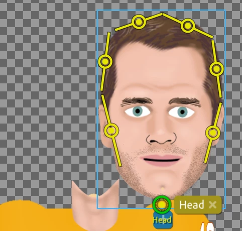

I also just noticed the handle for Head is just off the bottom of his chin. Normally this handle is where the head will pivot around it it should be in the layer overlap area between the head and neck
I usually extend the neck up behind the head to have something to attach to.

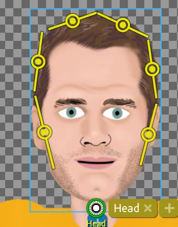

E.g. I manually dragged the head over to the side. Here is what you get.

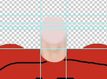

What I normally do is put a ball on the end of the neck...
So you can move the Head anchor further up.
The Head handle point is the point which the head rotaes around. You end up with a more natural movement by moving it a bit higher on the head.

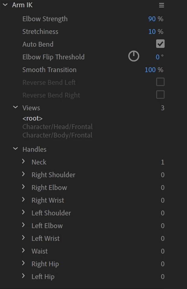

For the arm bends, you have the IK Arm behavior added, but its not wired up correctly.
See how 3 views are connected up? But there there is nothing connected to wrist tags etc. All the '0' mean it has not found the wrists etc, so its not stopping incorrect arm bending.
On you arm, you have lots of "Fixed" pins. Instead, I think it will work if you just extend the arm artwork up further behind the other layer at the shoulders. Not necessarily a problem though, just looked unusual. I would normally include the circle for the shoulder you have as part of the arm layer.
Remember the Elbow and Wrist handles for IK Arm go on the arm layer, but the Shoulder handles goes on the Body (the layer the arm attaches to). Otherwise it does not work.
