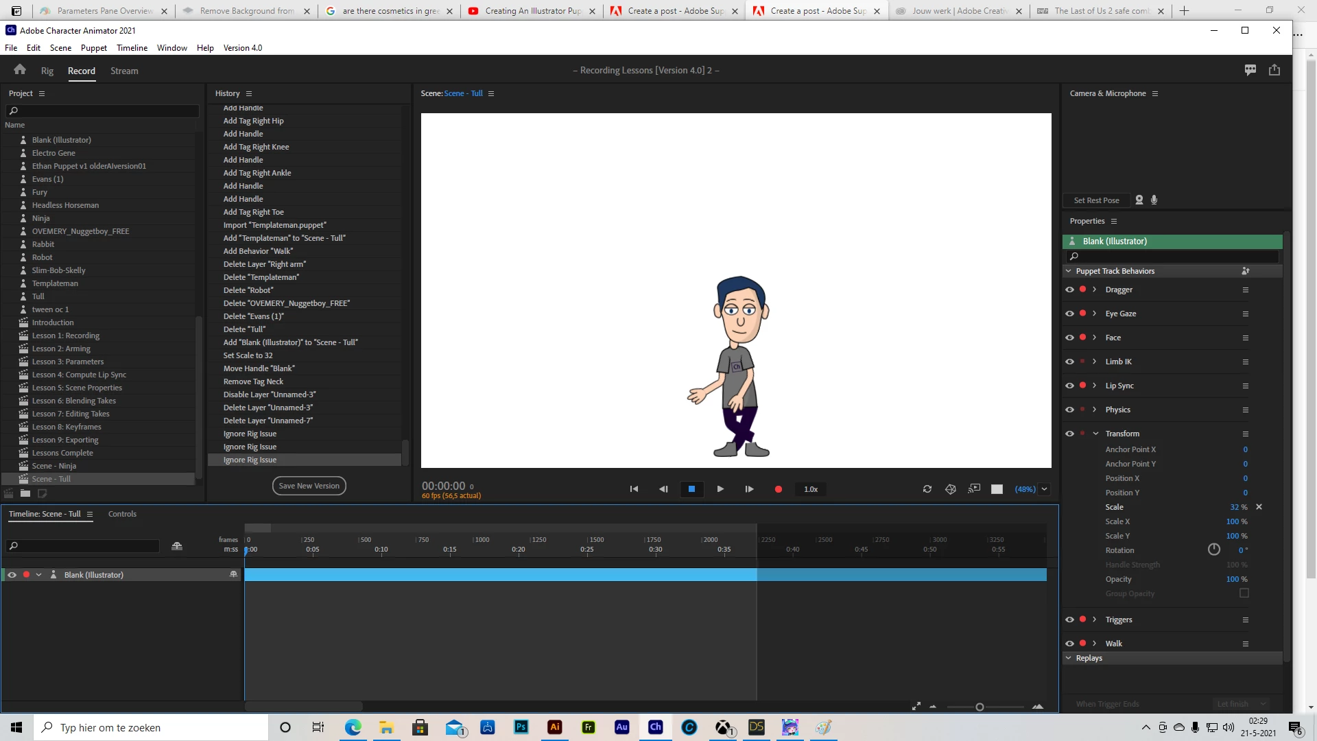

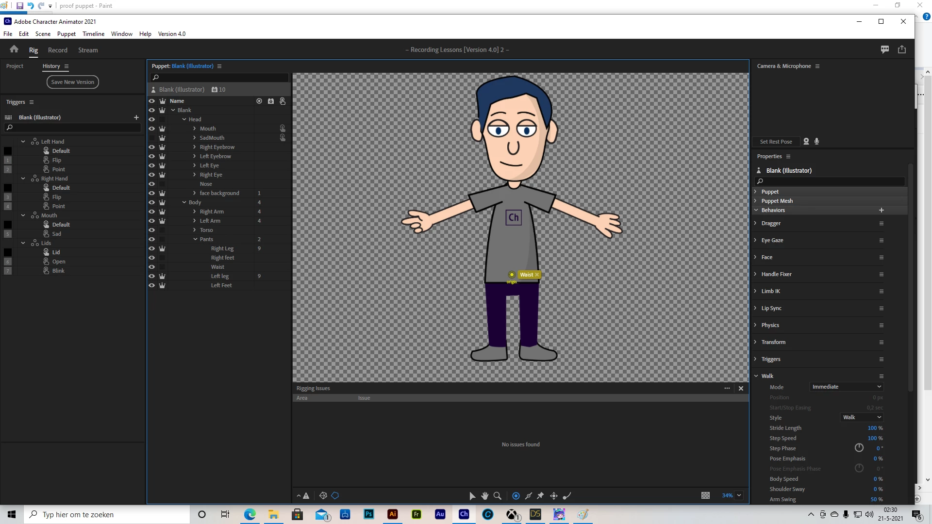

hey dave and the community i have a issue with my costumized blank puppet costumizing looks went oke but for some reason my arms looking like they been dislocated to the inside of the chest while performing a walking animation. also the legs seem to be not functioning properly its confusing cause ive not changed anything in the template layers which should by default work fine but at this point it doesnt i would like to get some help on it   ill leave some proof  of it down below

It looks like you added the Walk behavior, which can fight with Limb IK - both are looking for the same tags. Also the way this character was created, his legs weren't set up for walking or Limb IK, so the way they seem to be rigged here is incorrect. To start I would advise:
  • removing independence from the Body group and everything inside the Pants group
  • make sure a fixed handle is on the body group to pin him to the floor.
  • Remove the Walk behavior. If the problem persists, remove the Limb IK behavior as well.
