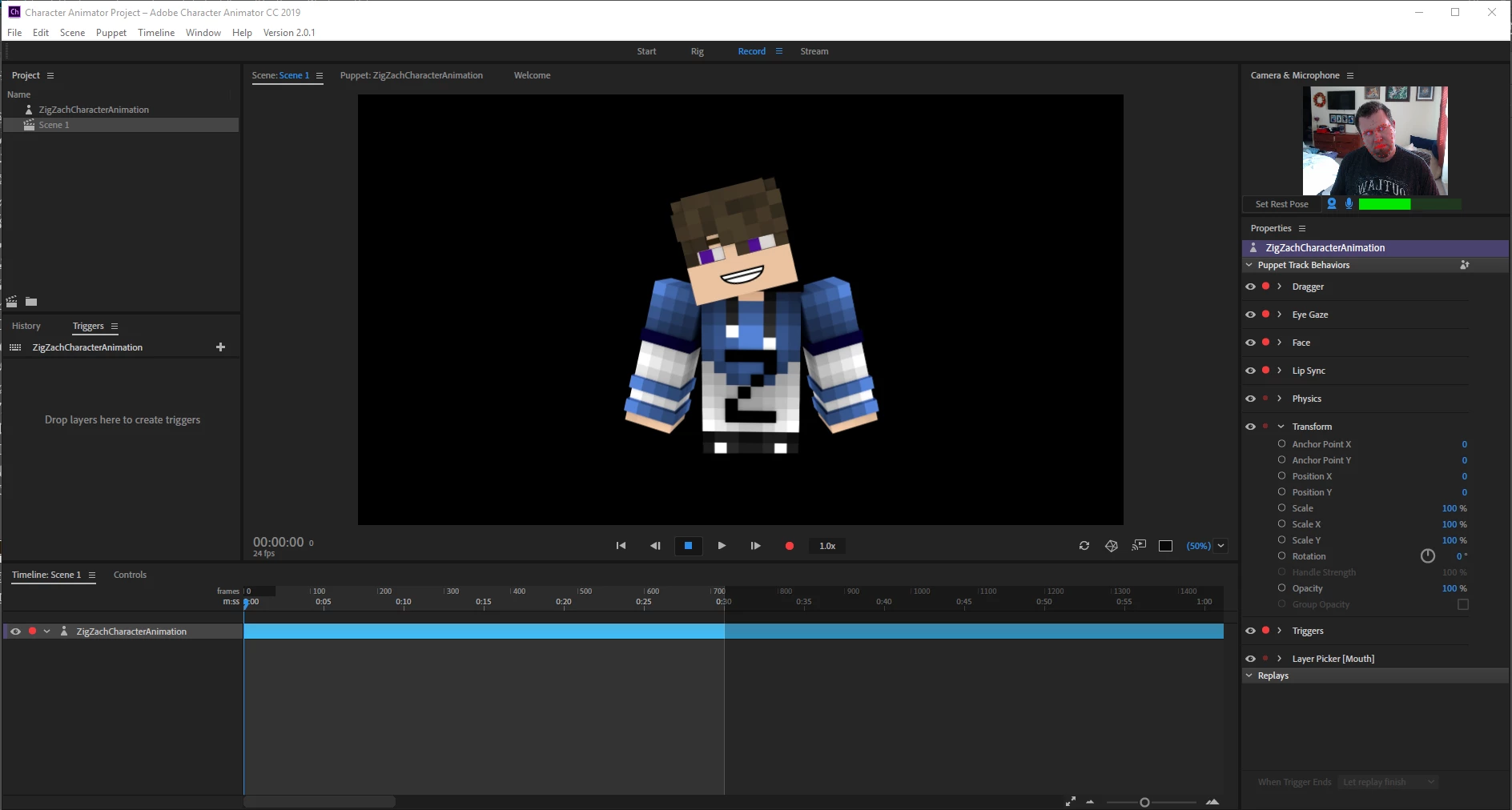

I'm trying to get my head to track movement and not warp and still have the body follow the movement. It seems I can either have the head move with the body (in which case the sides of the face warp, or the head move independently and body stays still.
in the screen shot below you can see the body is twisting which is correct, but the head is warping on the characters left.

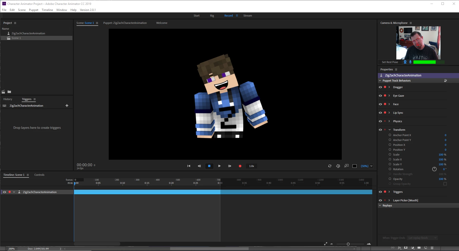

and below if I make the head independent it moves how I'd like it too, but the body no longer moves at all.
