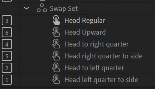

Ok so here's my swap set

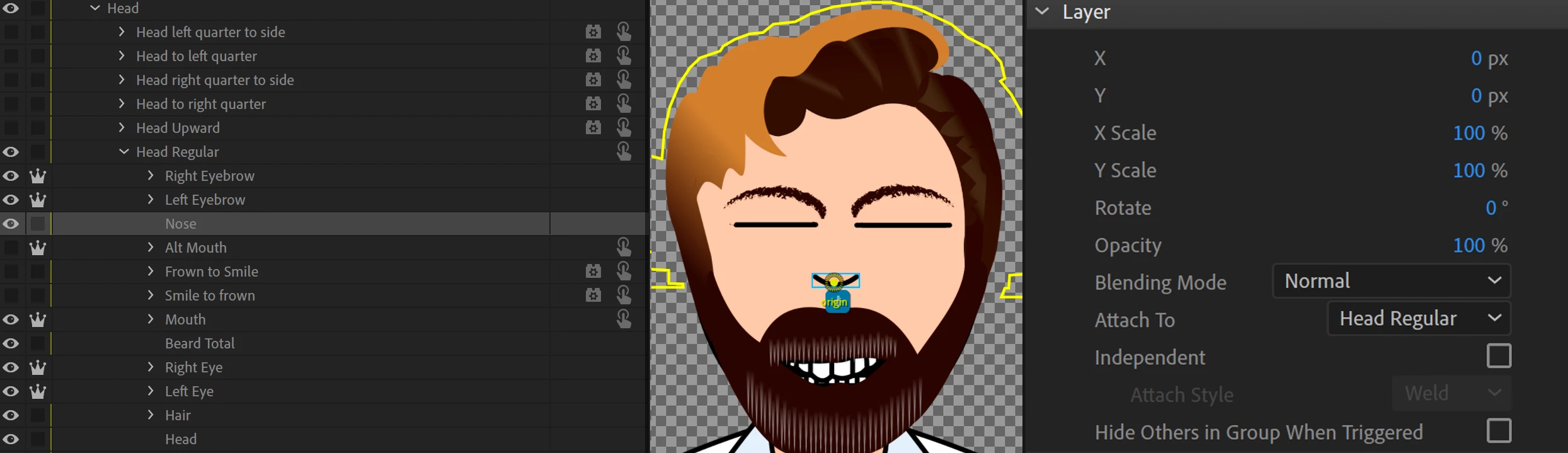

Here's how I have my heads grouped so far. with my regular nose being highlighted
And here's what I have for another one of my head's in case that's of any interest.
