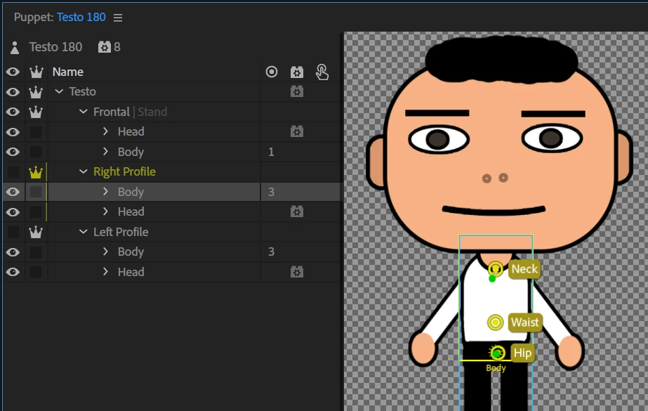

    Move the "neck" handles a bit lower. There needs to be a bit of a gap between the neck and head for it to warp. I moved it to where the shirt meets the skin on the neck. (It was at the top of the neck before). That helps quite a bit.

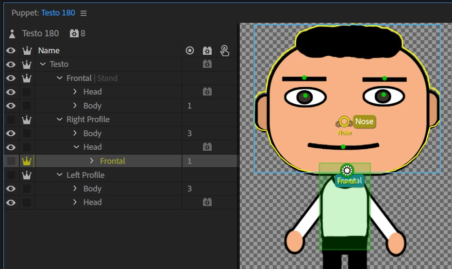

    I found the "Frontal" under "head" (which is independent) has a "Attach To" value that is not "auto". Change these to "auto", then move the anchor point of the "Frontal" over the neck so it goes green.

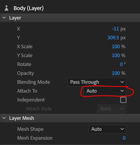

    Previously "attach to" was something like "Head" (not "Auto") which was a result of an old bug. Make sure all the attach to's for independent layers are "auto".

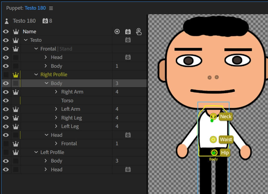

    Also check the yellow outline for layers maps the layers of the shape. For example, the diagram above is a rectangle. That means the contour is wrong (CH guessed it wrong). If you sent "Mesh Shape" to "Contour" that can force it to be correct. E.g. I clicked on "Body" then changed "Mesh Shape" to Contour" and the green area turned into the correct outline shape.
