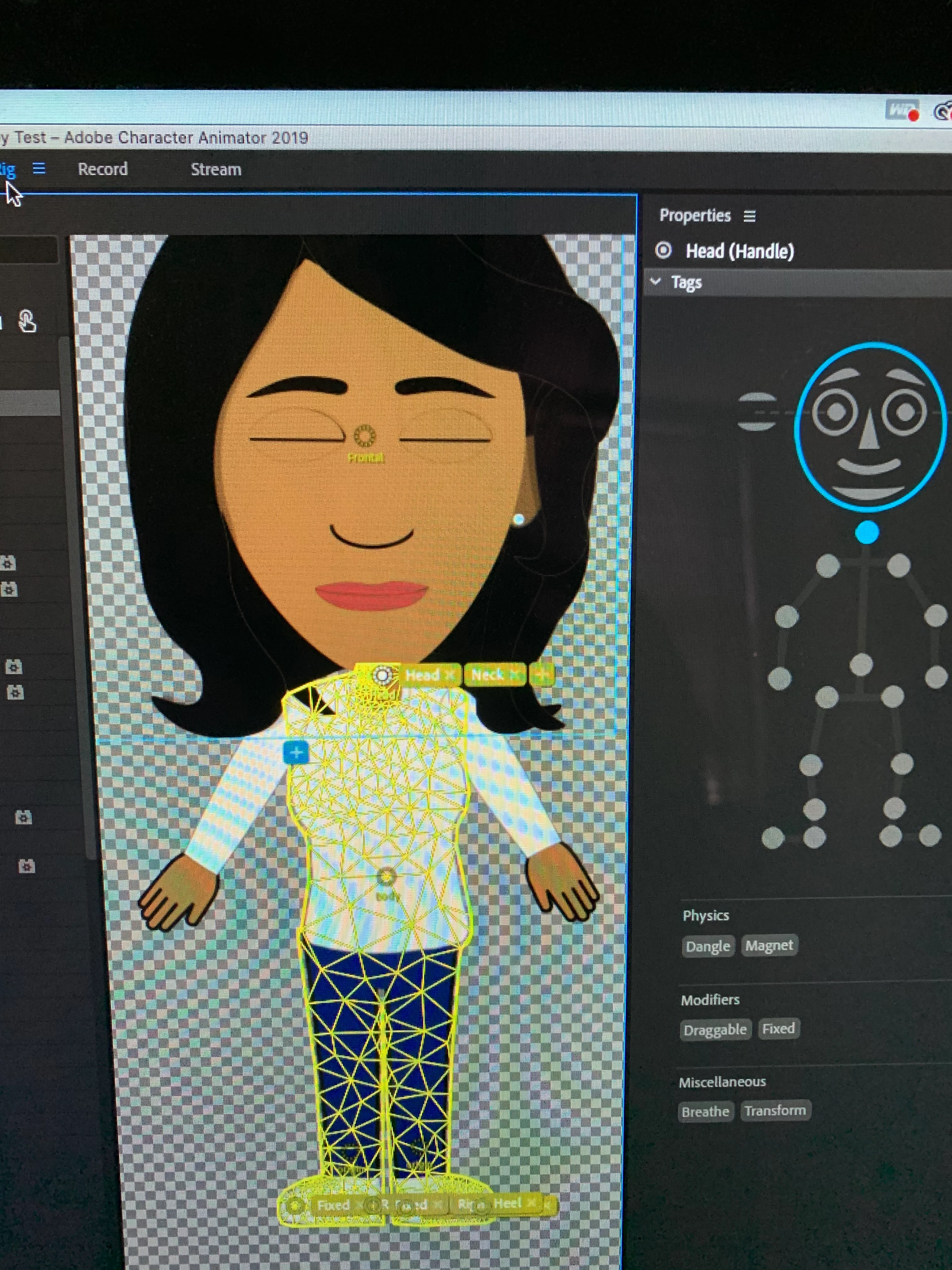

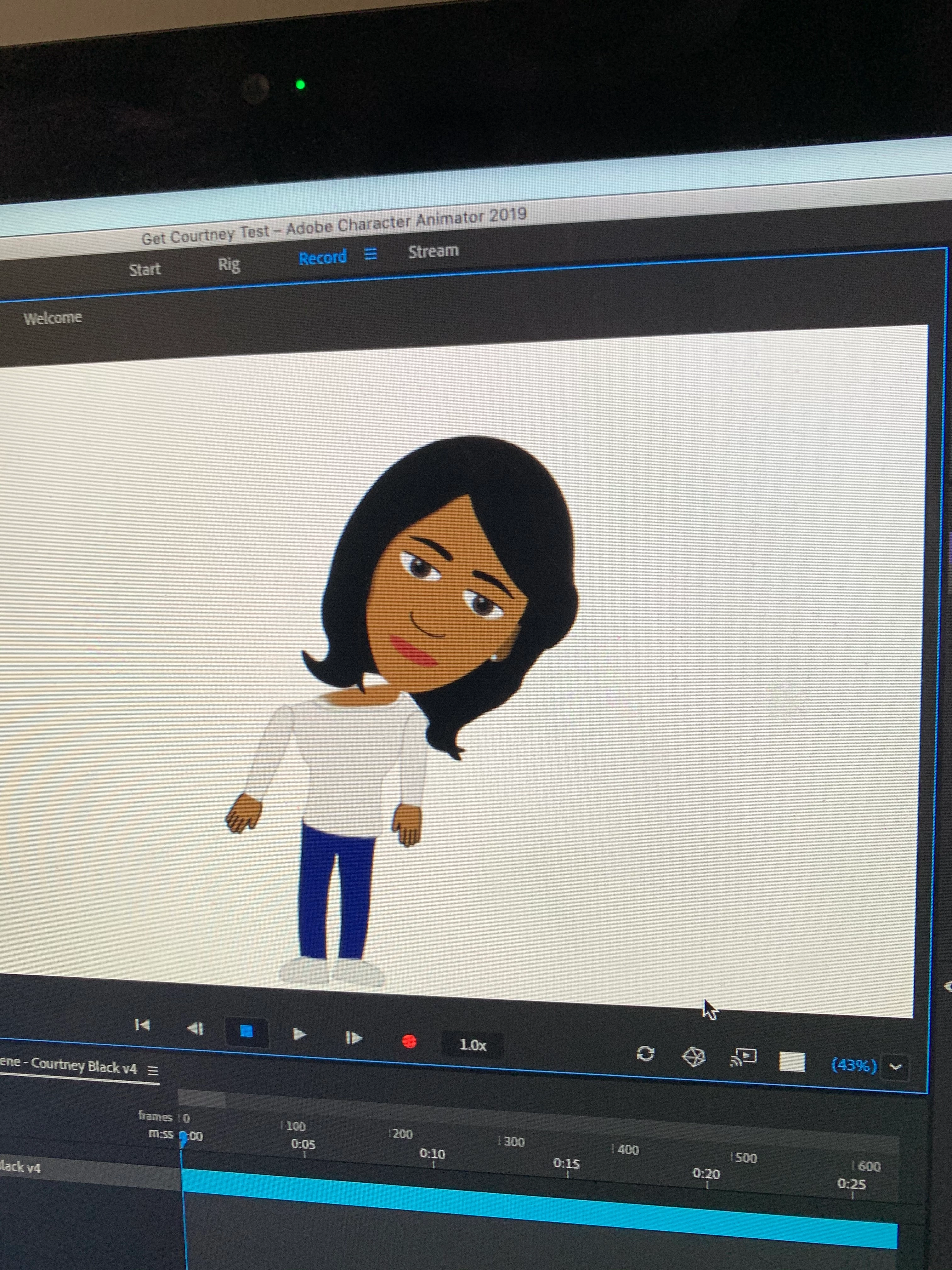

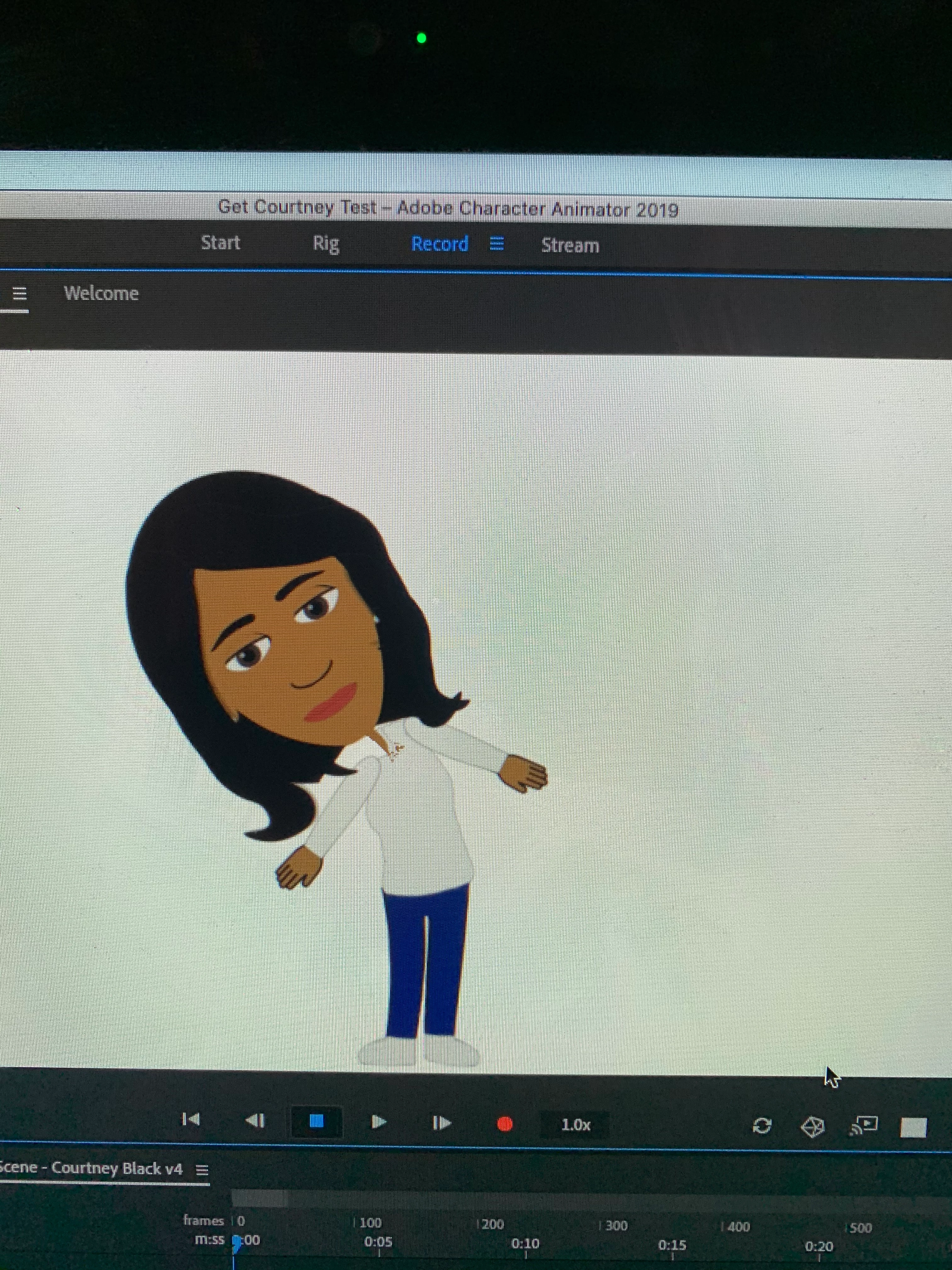

My puppet is warping in the neck/arm area... For some reason, the right arm doesn't seem connected to the body, and the head doesn't move by itself (even though I moved the "Head Icon" to my puppet's neck).
Please see images....
Could someone let me know what I'm doing wrong?

OK. There were several problems with the puppet. I go over fixing them in this video: https://youtu.be/HZ4Ss2L1e8E
And here's the .puppet file from when I was done: https://adobe.ly/2yrAQoR
