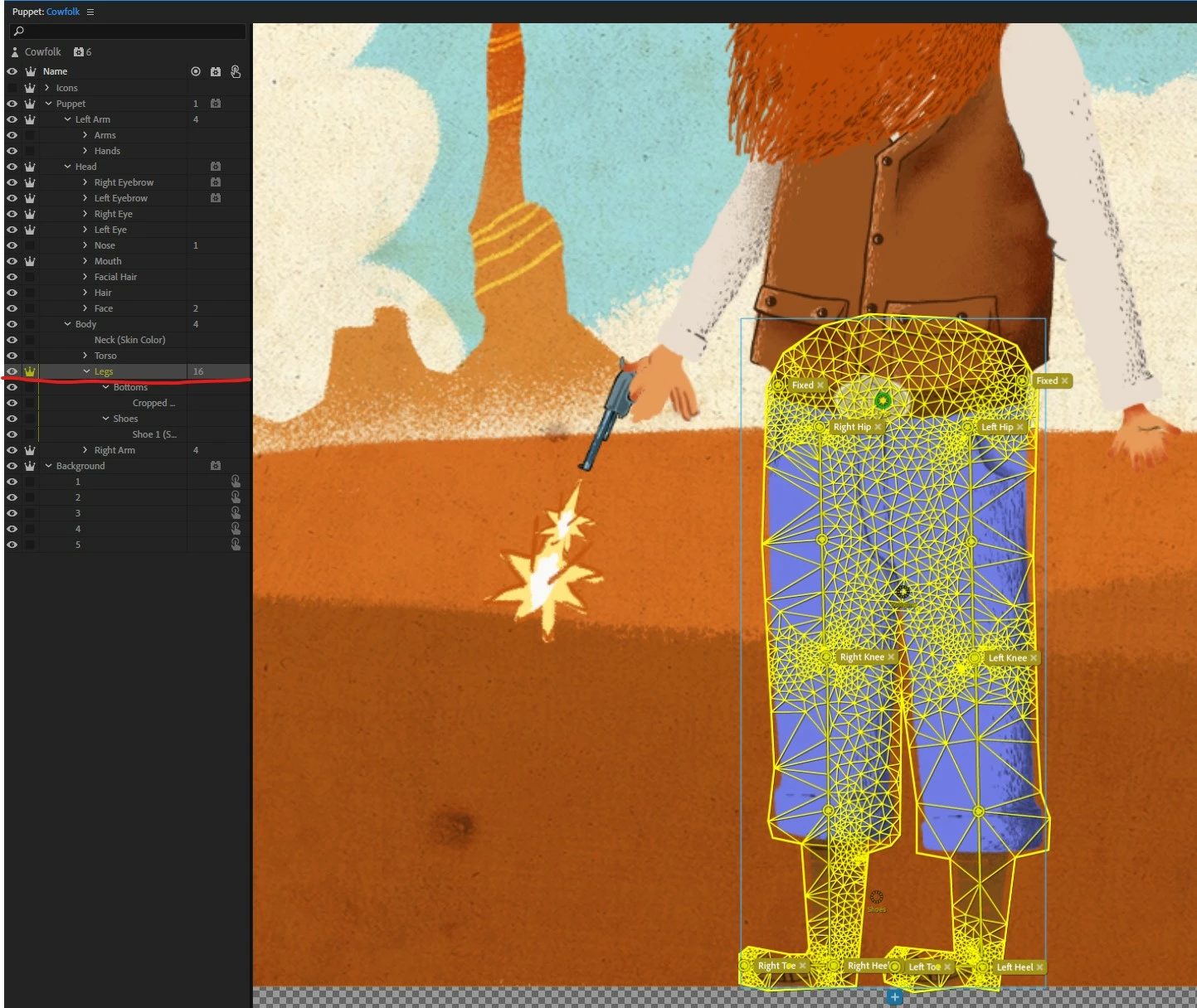

I am trying to use a customized Cowfolk puppet. He is 3/4 facing to his right. When he walks with Motion Library, his distant (right) leg comes over the top of his near (left) leg during the strides.
When I click the Edit Original icon in the Project panel and open the puppet in Photoshop, the puppet doesn't have a right leg and a left leg. It just has "legs." So, I can't put the left leg above the right leg to correct the layering problem.
Any recommendations on how I can fix this?

(This has nothing to do with the motion library. Any other means to animate Cowfolk legs will end up having the same issue.)
This is because Cowfolk's lower body is made up of a single "Legs" layer and CH has no way of deciding the draw order.

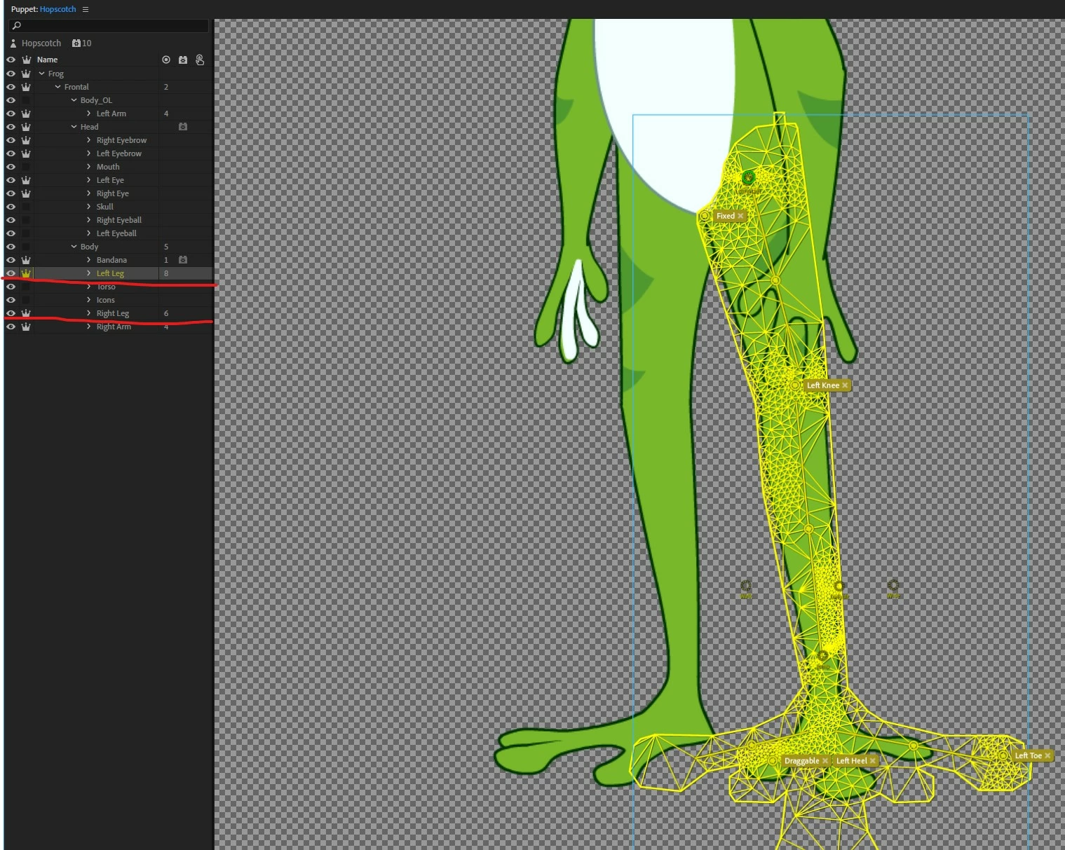

In contrast, puppets like Hopscotch do not have this issue because the left and right legs are independent art layers.
To fix this for Cowfolks, you have to go to the source PSD file, separate the lower body into independent layers, and re-rig.
