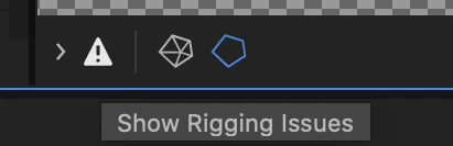

Do you have Cycle Layers on that mouth shape? If so, is Hold on Last Layer enabled?
BTW, the Rigging Issues section (enabled by the triangular button in the lower left corner) of the Puppet panel will warn you about problems like these:
