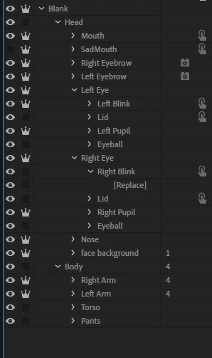

Please find attached screen grabs, pardon my ignorance but still learning everyday about Adobe character animator so not sure if this is even the correct screen grab. If there's anything else you require please let me know.
Thank you for sharing both of those files. One thing that stands out is that you have left blink marked as independent but right blink is not. Usually, the blink is not independent for either eye. I do not know if that is your issue or not. Also perplexing is the "lid" state in your swap set. I don't know what it is for since you also have an open state. Logically, your open state should be your default and the closed state would be your default. After you address that, you might want to test the blink action by setting the closed state to "latched" just to confirm that it is indeed closing.

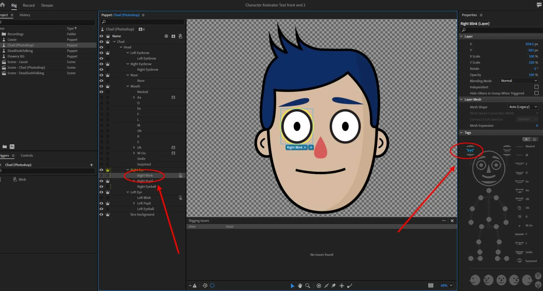

I checked and the blink layers already existed and tagged too.
When I press the trigger button its not responding and the eyes still remain open. All the other triggers work perefectly.

Could you share a screengrab of your layer hierarchy so we can see how the layers are set up for either eye?
mrmeznaAuthor
Mar 30, 2022 8:48 PM UTC
Mar 30, 2022 7:09 PM UTC
Make sure "Blink" exists in your rigging layers and that it is tagged as well. See circles on attached.
