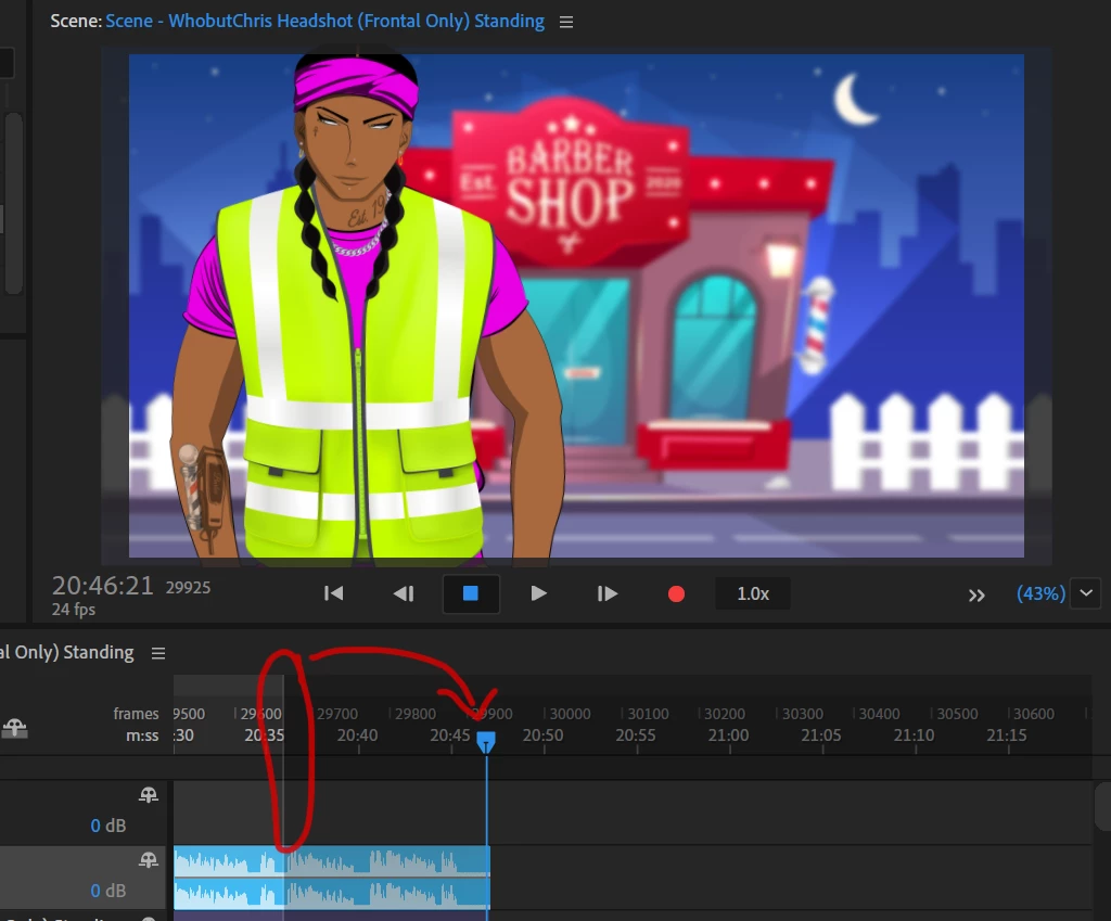

My audio cut off where it's circled at. Is there a way I can drag it all the way down to the 20:46 mark where the audio ends? Thanks in advance.

I think your scene duration is shorter than the recording. If you put the playhead at the end and right click on it, I think you can set duration to that position. Otherwise, single click on the scene in the project panel, and adjust the duration in the properties panel.
