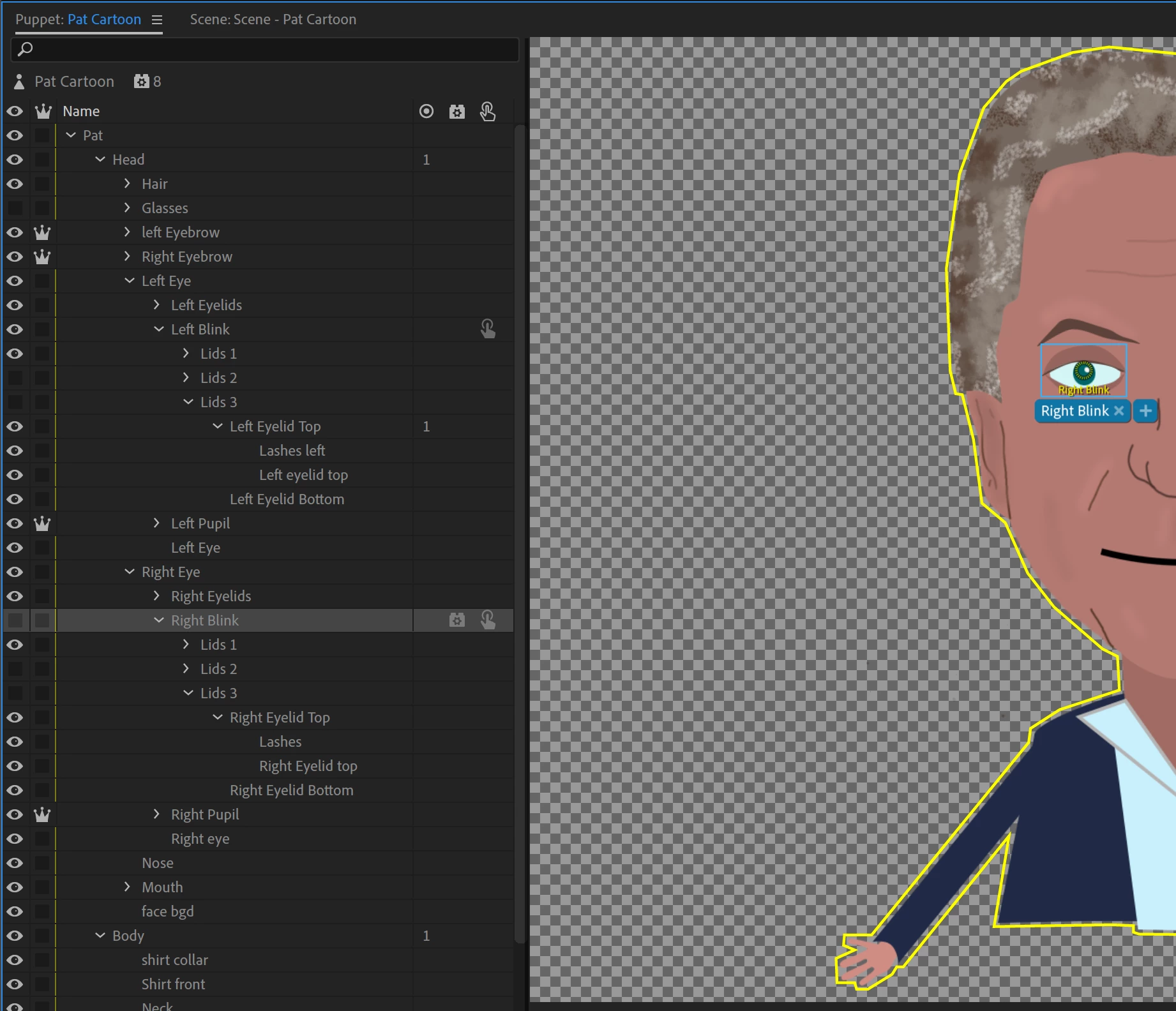

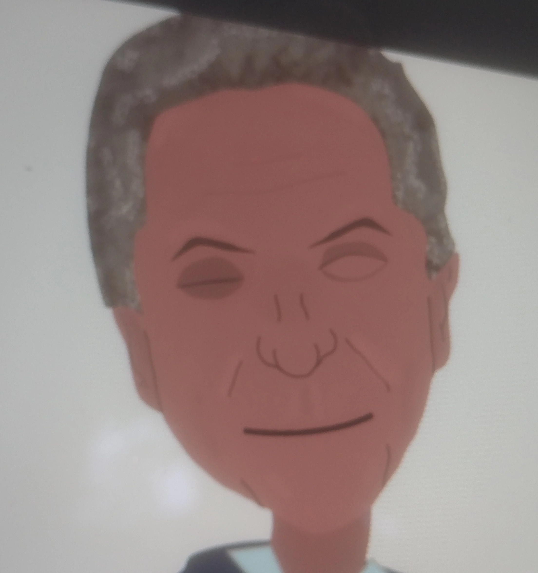

Now I have a new problem. I've got it set so when I use keyboard trigger for the blink, and hold the key down, the right eye remains on the correct 'closed' layer, but the left eye holds on something else. See first screencap for the issue, 2nd for my rigging.

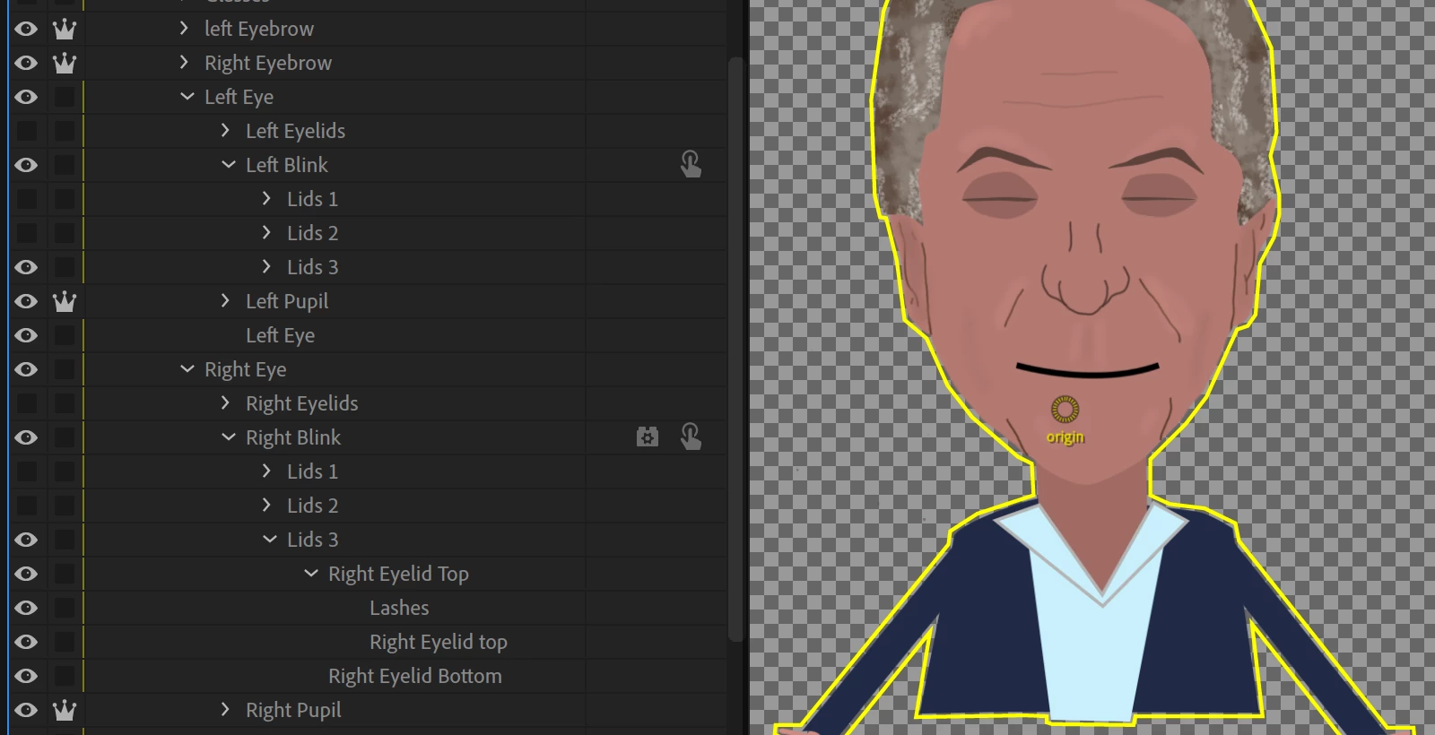

In the 3rd screencap I've enabled the 3rd blink layer for left and right, so you can see the desired look of a held blink.
