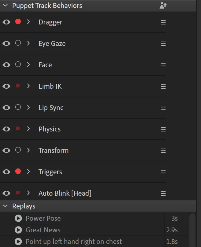

Yes they're all activated. I've attatched a sample image...
alank99101739
Apr 25, 2022 3:44 AM UTC
The screenshot shows draggers and triggers are enabled for recording (the red dot), the others are not. (That might be okay - what does the trigger recording contain? Does it contain dragger and trigger recordings only? Or other things like eye movements?)
If you start recording, do a manual thing with the puppet like what is in the replay, then trigger a replay, then do another manual thing, then stop recording, what does the recording contain? All 3? None? The manual things only?
The confusing thing you are saying is the puppet follows the trigger, so the trigger is working. I cannot think of why if you go into record mode with the right puppet etc selected, the right behaviors with the record button on, my understanding is the replay is just like you doing it manually. I suspect you have something to do with the record mode wrong, hence the experiment in the previous paragraph.
