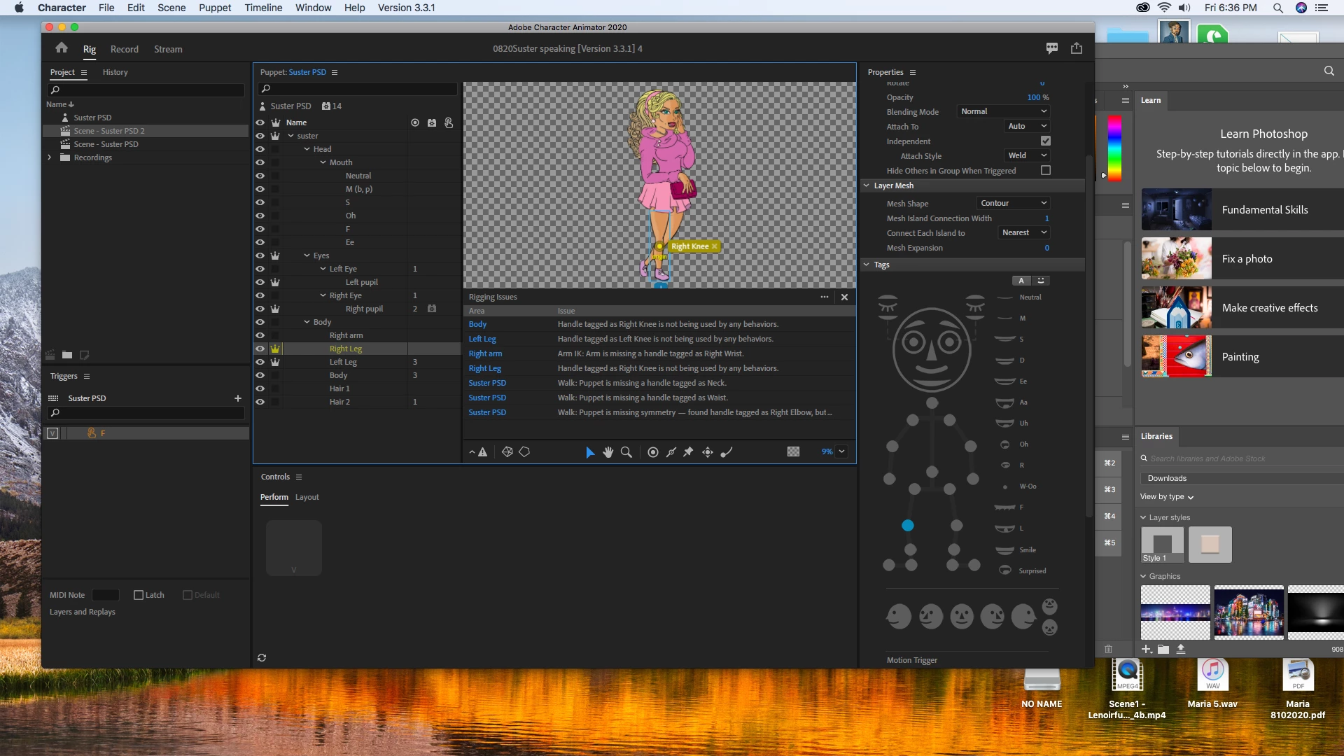

What do I need to do to fix theses issues Please help!

  • Body/Right Knee: Your legs are independent, so you need to put the right knee handle on the Right Leg layer, not the Body layer (see th Body layer with the number 3 next to it? Its probably on that layer). I know you can see the "Right Knee" handle when you select the Right Leg layer (i dont understand that to be honest!) but see in the hierarchy there is no number next to "Right Leg"? That indicates there are no handles on that layer. So delete the existing Right Knee handle, select the Right Leg layer, then add a handle back on the knee again.
  • Left Leg/Left Knee: Hmmm. Ummm. The Left Leg layer has 3 next to it, so it probaby has the handles on the correct layer. What I would do for this one is can you find the walk behavior, then expand the handles and views sections and share a screenshot? I am guessing it did not find the hips. I *think* they need to be on the Body layer (similar to shoulder handles must be on the body layer, not the arm layer). My guess is when it did not find the hips it did not look for knees etc.
  • Right Arm/Arm IK: You need to add a handle on the right arm if you want to use the "Arm IK" behavior for the Right Wrist. I am not sure you need the Arm IK behavior by the way - so it might be you should delete the behavior until you know you need it.
  • Right Leg/Right Knee: Same as above - I suspect it did not find the hips.
  • Suster PSD: if you want to use Walk, you need a Neck handle. i would put it on the body layer in the middle of the shoulders (ie the bottom of the neck). I think it works better if directly below Head (not to one side). The head sort of hunches over otherwise (sometimes).
  • It did not find a Waist handle. Either delete the walk behavior if you don't need it, or add a waist handle on the body layer. It generally goes between the Left/Right hips (a bit higher is fine). If it does not find the waist, I think it gives up on the legs, which would explain the knees.
  • The last one seems to be saying the Walk behavior found Right Elbow handle but not a Left Elbow. That might be ok, but it thought it strange. I am not sure you want a walk behavior yet! Lol!
