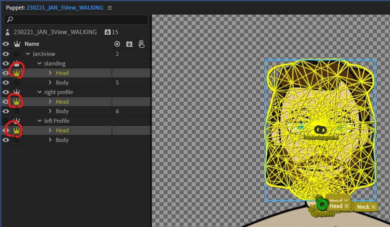

Minimal recommendation: make the head layers independent (crowned)
This at least makes the puppet's head follow the body better with the Walk behavior.

j-saitoCorrect answer
Adobe Employee
Mar 8, 2023 9:27 PM UTC
