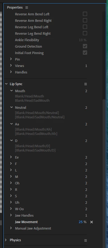

Hi, I'm working on my second Ch puppet. Everything looks fine apparently - no rigging issues found.
However, when I compute lip synch, it works perfectly for the neutral mouth. But when I trigger the sad mouth, the lip synch remains in neutral.
The default sad mouth will trigger independently, but does not compute with lip synch. The lip synch properties are seeing both sad mouth and neutral for all mouth shapes. I'm attaching a couple of screen shots. Any help or guidance would be gratefully received!

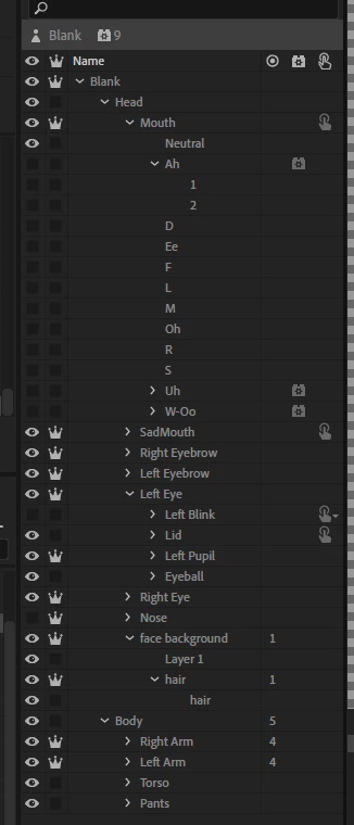

What does your swapset look like? Take a look at Chloe from the home screen and make sure it's set up exactly like her. It looks like the tags are working given the "2"s you're seeing on the left, but my best guess is the swap set is running into issues somehow.
One way to check this would be to temporarily delete the "Mouth" group in CH and see if the remaining sadmouth set works. That way you know you have a working mouth, and it's just a matter of figuring out why it isn't triggering properly. If it still doesn't work, then something with the mouth rigging itself is faulty.

You need to manually add a mouth tag to the sadmouth layer, or rename it to include a space "sad mouth". It probably is not recognizing it as a mouth.

- I changed the layer to sad mouth but this didn't have the desired effect. The lip synch still only works on the neutral mouth, although all of the sad mouth visemes will trigger when the character is not animated.
- I tried manually adding a mouth tag to the sad mouth layer, without success – this gives me the error message "Handle tagged as mouth is not being used by any behaviors". Otherwise Ch is not detecting any rigging issues.
