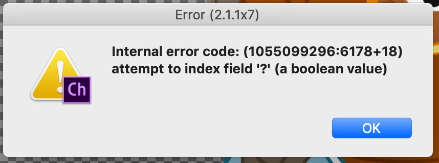

I was working in CA this morning (2.1.1) and suddenly as I was going back to the rig panel from record the scene starting throwing an error, and it's stuck in an error loop.
As far as I can tell, the scene is completely useless now and all my time and work is gone. Adobe needs to put the saving process in the hands of the user, not an auto-save without redundancies.
Has anyone recovered a scene that went south?
Attached is a screenshot of the error it's throwing.
Thanks.

Sorry you ran into this issue. The error seems to be that a mouse event hit the rig panel before information about the selection/drawing state had been initialized. I can see what ordering of operations would be required for this to happen, but haven't been able to figure out how to elicit it quite yet.
I think the shortcut that might help here is to open the project while holding shift which clears some UI state and and can help avoid bugs that are related to selection state like this one. If this bug does survive and recur on a relaunch of the project, I would be a little curious to get a copy of the project (Alan's description of the process of zipping it up and using a file transfer service download link is spot on), but if you've already moved on, that's ok, too.
