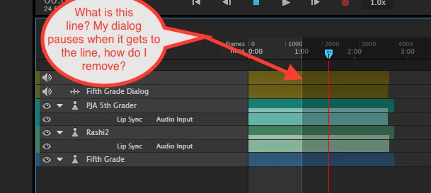

I have a scene with two puppets. After I uploaded the dialog for both puppets and synced the lip sync a strange line/highlight appeared in my timeline. Now when I run the scene back, it pauses when it gets to the line / highlighted portion. How do I remove that?

    Here is an example. My scene duration is 19 sec, and that is where the line is. Just change your duration to about 3 and see if the line moves.

    THANK YOU! I figured it was something easy.

    Mar 29, 2017 7:23 PM UTC
    That line looks like the point of your scene duration setting. What scene duration have  you set?
