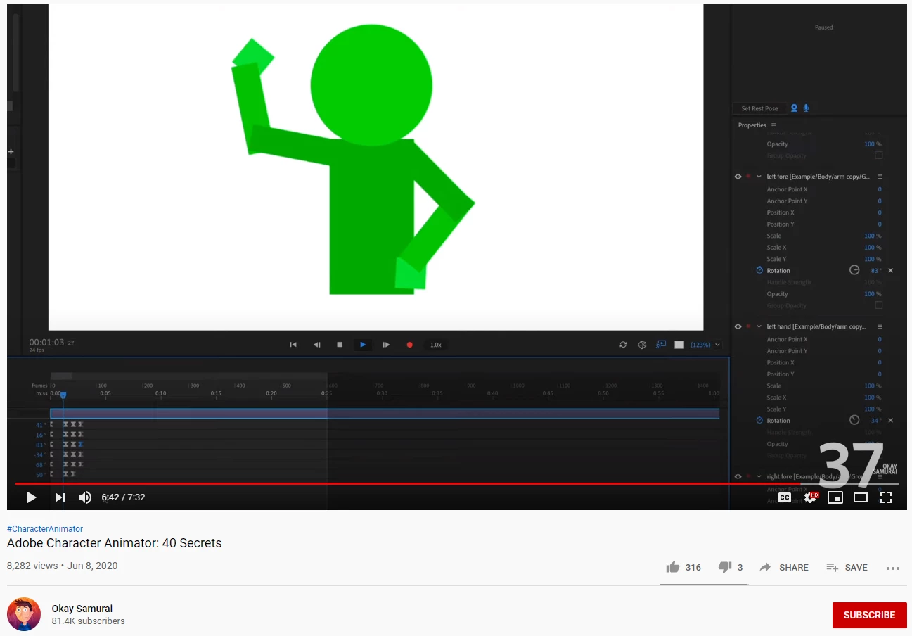

I literally don't know if this is possible in Character Animator either, although i did manage to find something close around the 6:30 mark of the 'Adobe Character Animator: 40 Secrets' video, in which he used transform behavious on segmented arm layers to create a similar effect:
As great as this is, it seems that it isn't possible to have the lower arm layer over the top of the uper arm, as the lower arm cannot connect to the upper arm if it's above it in the layer hierarchy.

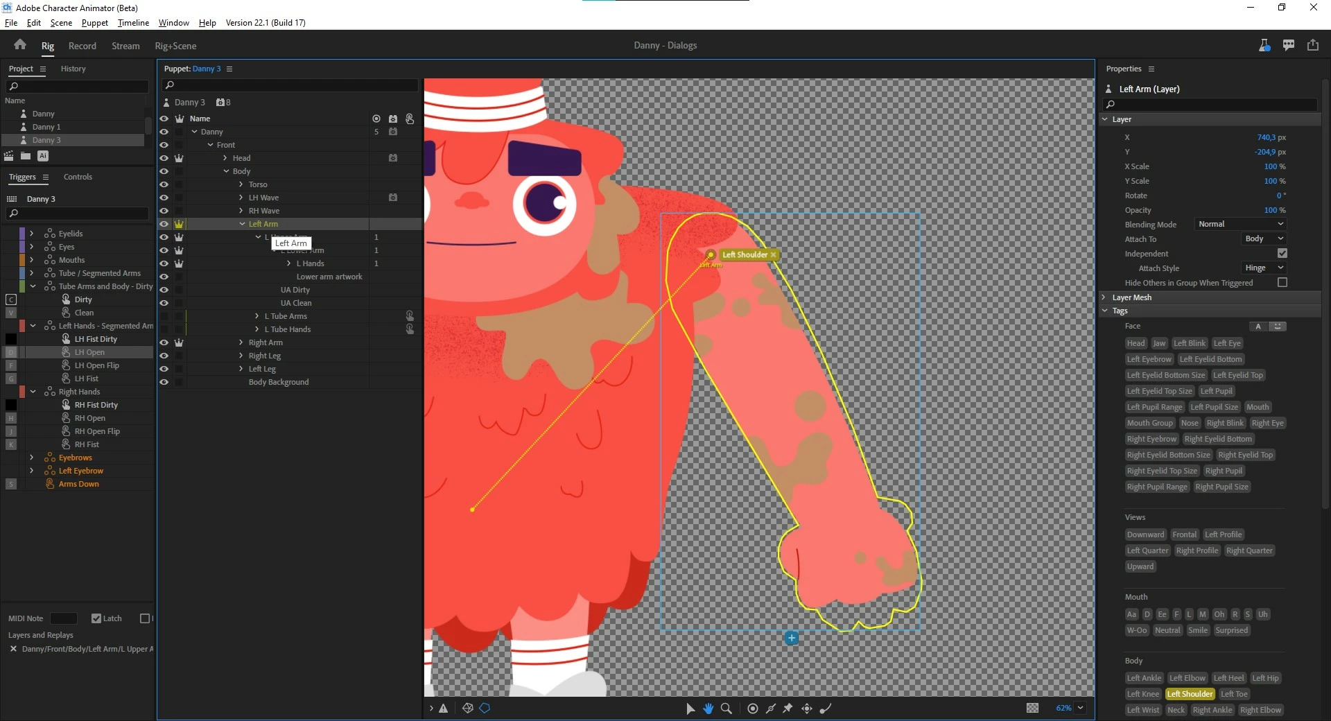

Hello Alank. I've been trying to follow your recommendations here to do a pin-joint-type puppet. However, although I've nested the parts of the arm, used Attached to, and used Hinge as you suggested, the arm segments don't drag each other properly. They just pivot at their origin without dragging anything. Could you PLEASE have a look at where I might have detoured from your suggestion?
alank99101739
October 11, 2021
At work at the moment, but the origins when they overlap the parent artwork should turn green to indicate attachment. Not sure why they are not green on your screenshots. Are you able to "Export Puppet" from the menu, share that file via Google Drive or Dropbox or similar? It shares the artwork and rigging hierarchy. On the surface what you are doing makes sense, but obviously something is going wrong. If you are allowed to share the puppet, it can help diagnose quicker. (If you share on the forums someone might jump on before I can after work, otherwise feel free to direct message me.) I think you are 90% of the way there.

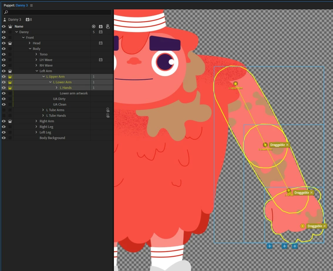

There is a trick to it and restrictions. To get the layers correct is not that hard actually. To have the lower arm over the top of the upper arm you just move that layer higher:
Body
. +Arm
. . +Lower Arm
. . . +Hand
. . . . Hand artwork
. . . Lower arm artwork
. . Upper arm artwork
The hand is then in front of the lower arm which is in front of the upper arm. (You then use "Attach To" of type "Hinge" not "Weld" to get the pin effect.)
The problem is when you come to draggers. If the arm  is independent to the body, you will need a dragger near the elbow of the upper arm, and another dragger at the wrist (at the end of the lower arm segment). Without this, dragging at the wrist will not move the upper arm. This is because nested independent layers will not move the parent. So you have to record the elbow drag and the wrist drag with this puppet. It works, but is more work during recordings. (If the Arm can be dependent you avoid the problem - but as soon as you have two independent nesting levels the problem occurs - each level needs a dragger.)
Does that answer the question?
