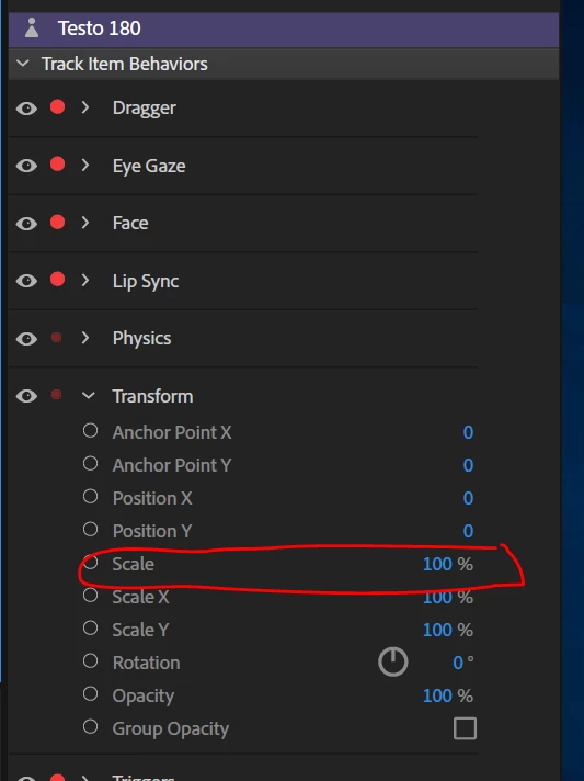

To make the puppet fit in the stage, you can use the "Transform" behavior of the puppet. It has a number of settings including "Scale". Try a value like 50% in the timeline - this will shrink the puppet to fit better. (I think having high res puppets is a good idea so you can scale up/down without pixelization - so the puppet is fine - just scale it smaller using the Transform.)
That is, select the puppet in the timeline...
Then look for the "Transform" / "Scale" setting.
