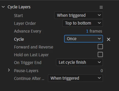

These are the settings I have for the smoke layer.
I'm not sure what I am doing wrong. I tried to switch the layer order from top to bottom and bottom to top but it still doesn't work.

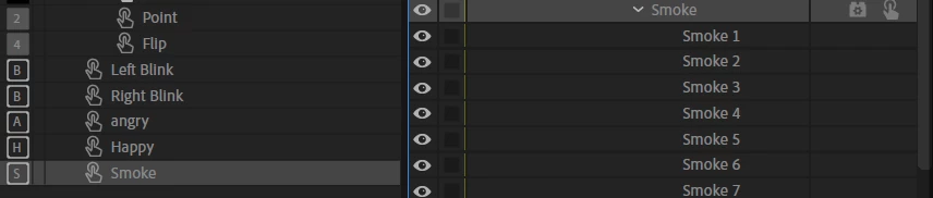

On the surface it looks correct. You have not made a silly little mistake like putting the artwork in the final group by accident?
Things I would try - change the frame rate, click the refresh button in the scene window (then repeat with SHIFT and ALT) - it flushes some caches, try hold on last frame. I assume you don't have multiple profiles? Try hiding the group so trigger turns it on. Try exporting and importing the puppet is another way to refresh the definition.
As I said, it looks fine, but nobody has reported a real bug with cycle layers in a long time, so it feels solvable. Feel free to share the puppet if you get stuck.

What do you mean by:
"You have not made a silly little mistake like putting the artwork in the final group by accident? "
