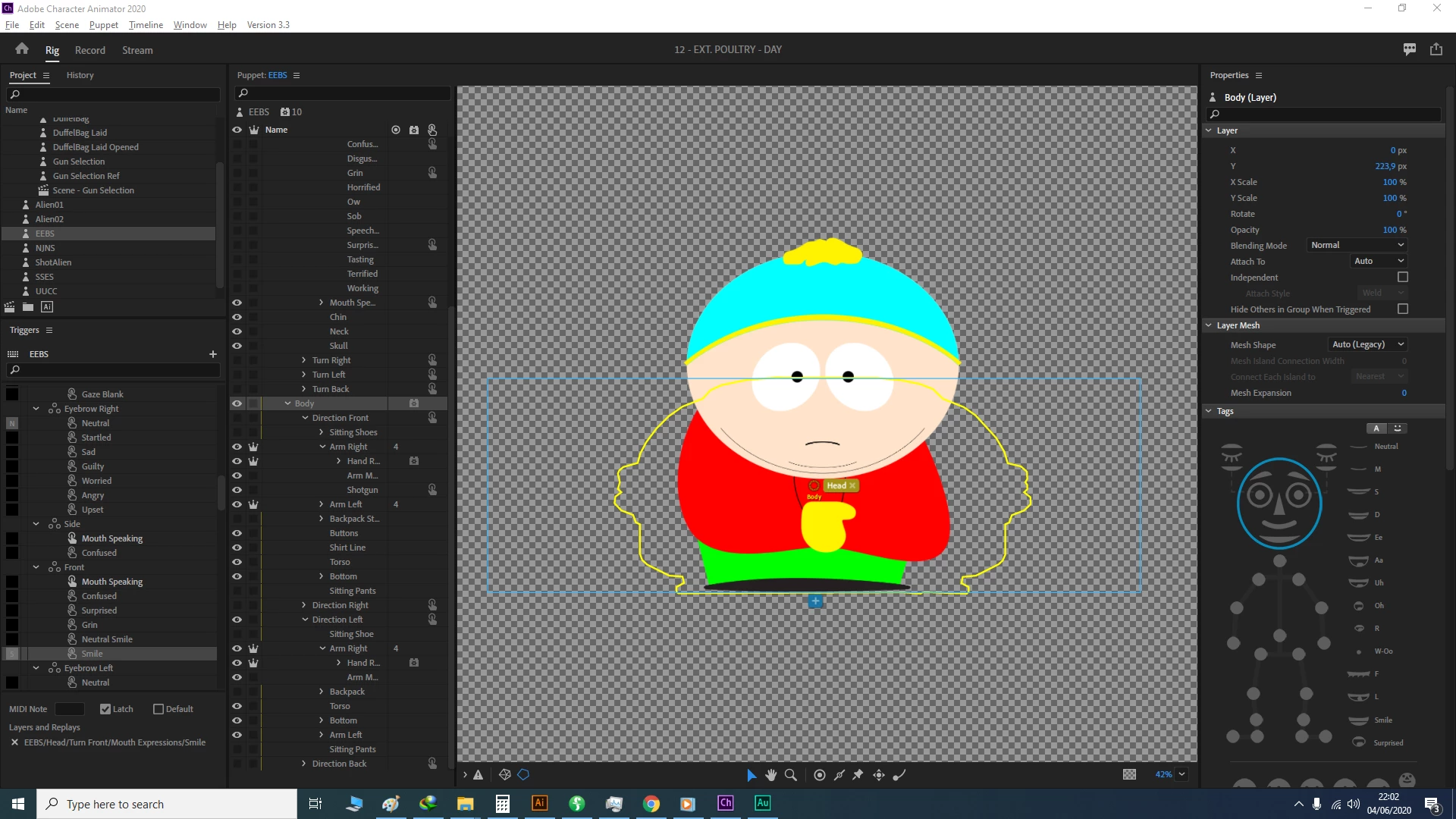

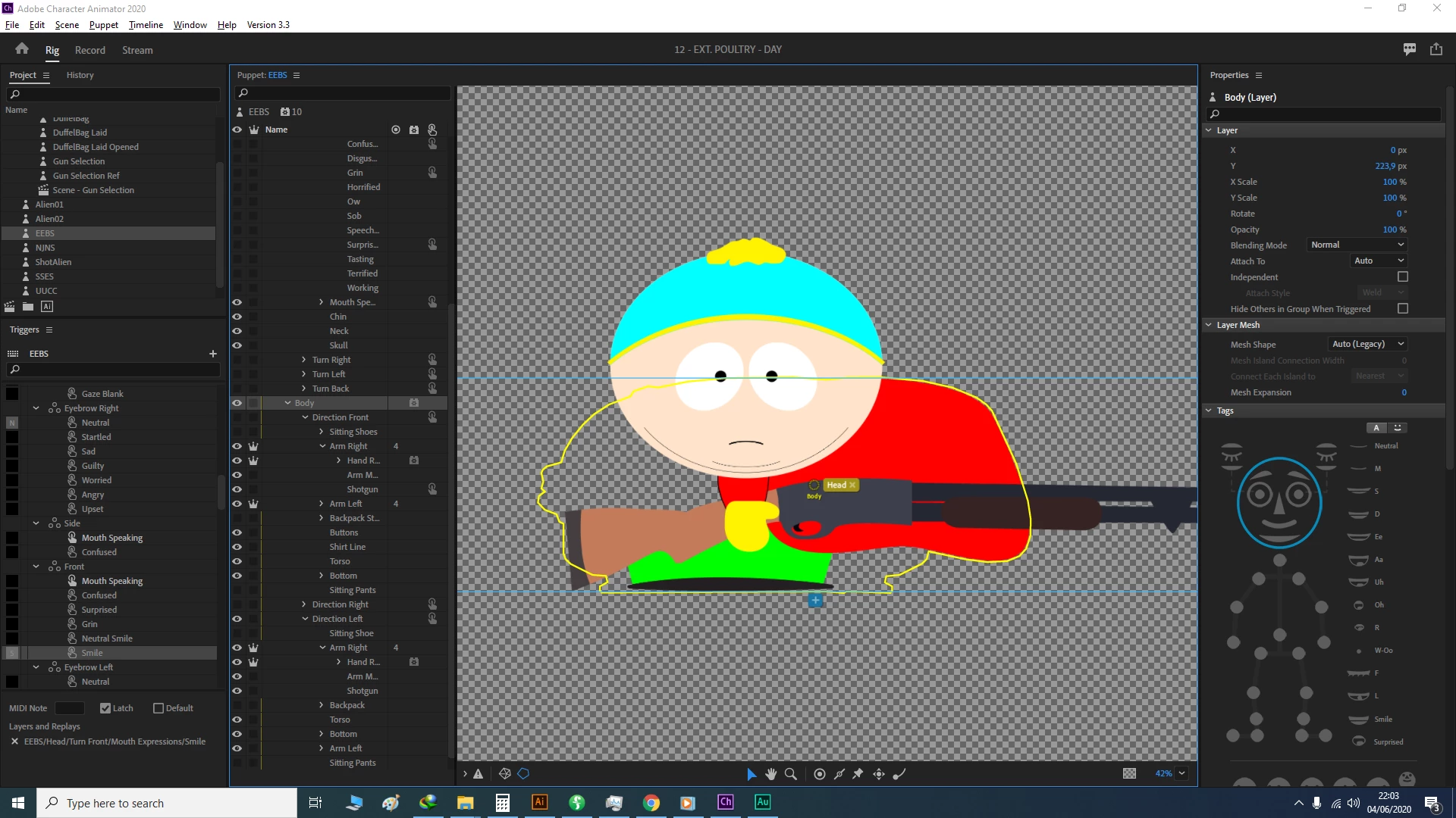

I don't know what the title should be, but here we go:
As you can recognize immediately, h̶e̶ ̶i̶s̶ ̶a̶ ̶C̶a̶r̶t̶m̶a̶n̶ ̶r̶i̶p̶-̶o̶f̶f̶  the puppet body is weirdly positioned by Ch. I guess it has something to do with pivot point? But I don't know how to fix it. Please someone help.
Thank you!

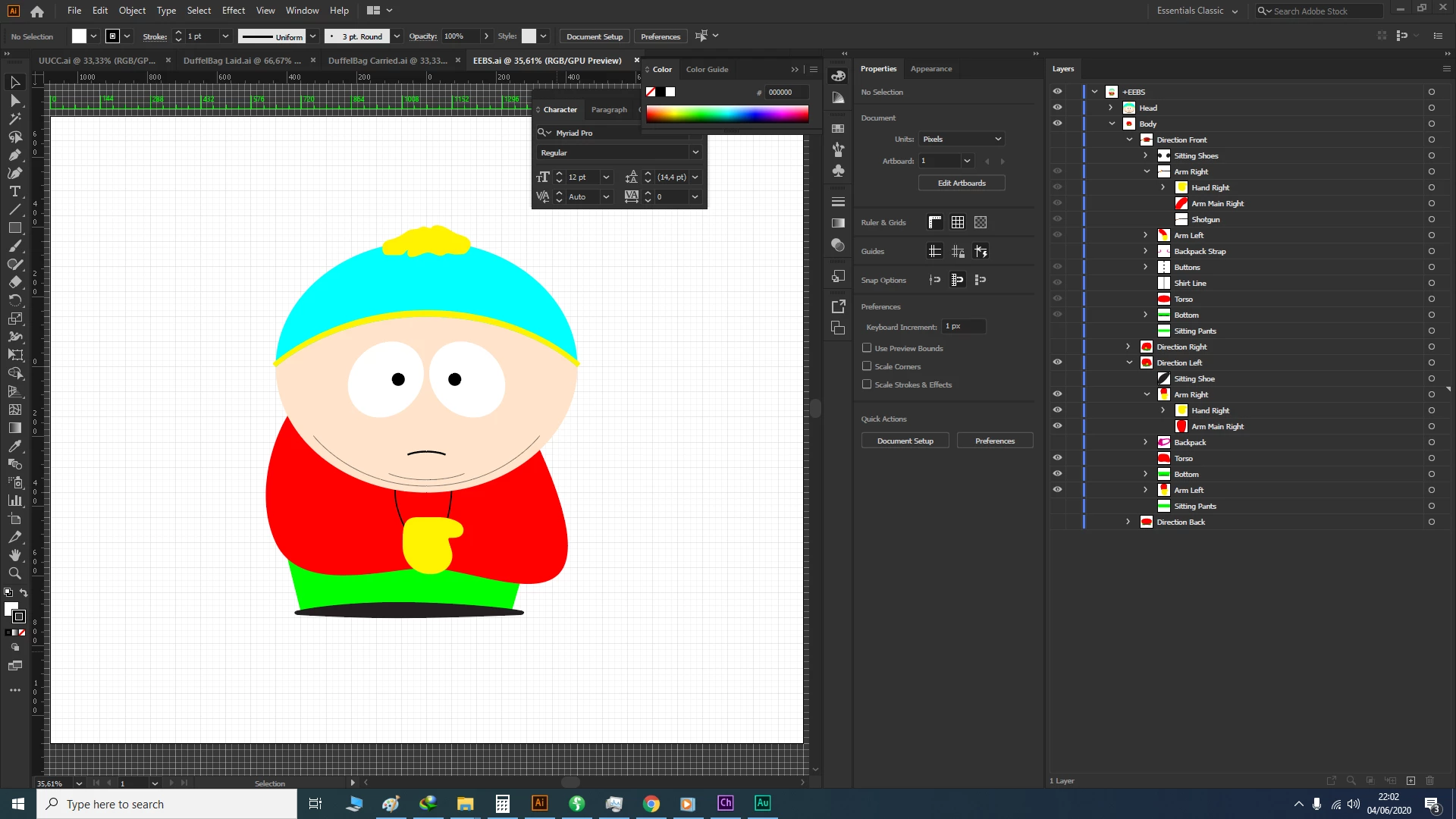

The torso is the one having problem, that is, the red colored chunk of the puppet, while the rest of the body is not affected by the shotgun. Therefore I edit the puppet in Illustrator by moving the torso out of the body group, save it, return to Ch. And then after the Dynamic Link synchronized, I return to Illustrator, put back the torso layer to the body group, tadaaa, problem fixed.
I am sure it is a bug for this version. Hopefully the Dev team will manage to get rid of it on the future release.

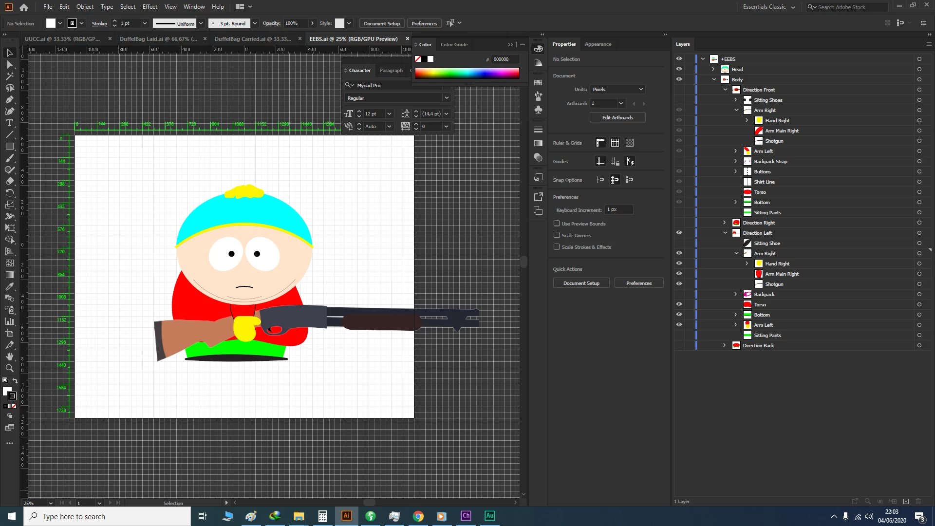

Did you add the rifle after the original puppet was created?
I have seen a similar problem before when the central origin of the puppet changes after editing the artwork. I dragged the layers back in CH, but it was strange. Could be a bug  - but would be confirm to see if the same as what I saw once before.
ebenheizerm28787053
Jun 5, 2020 5:40 AM UTC
Yes. The shotgun was added later on. So what should I do now? I don't want to redo everthing from zero as I already made some recording with that puppet.
