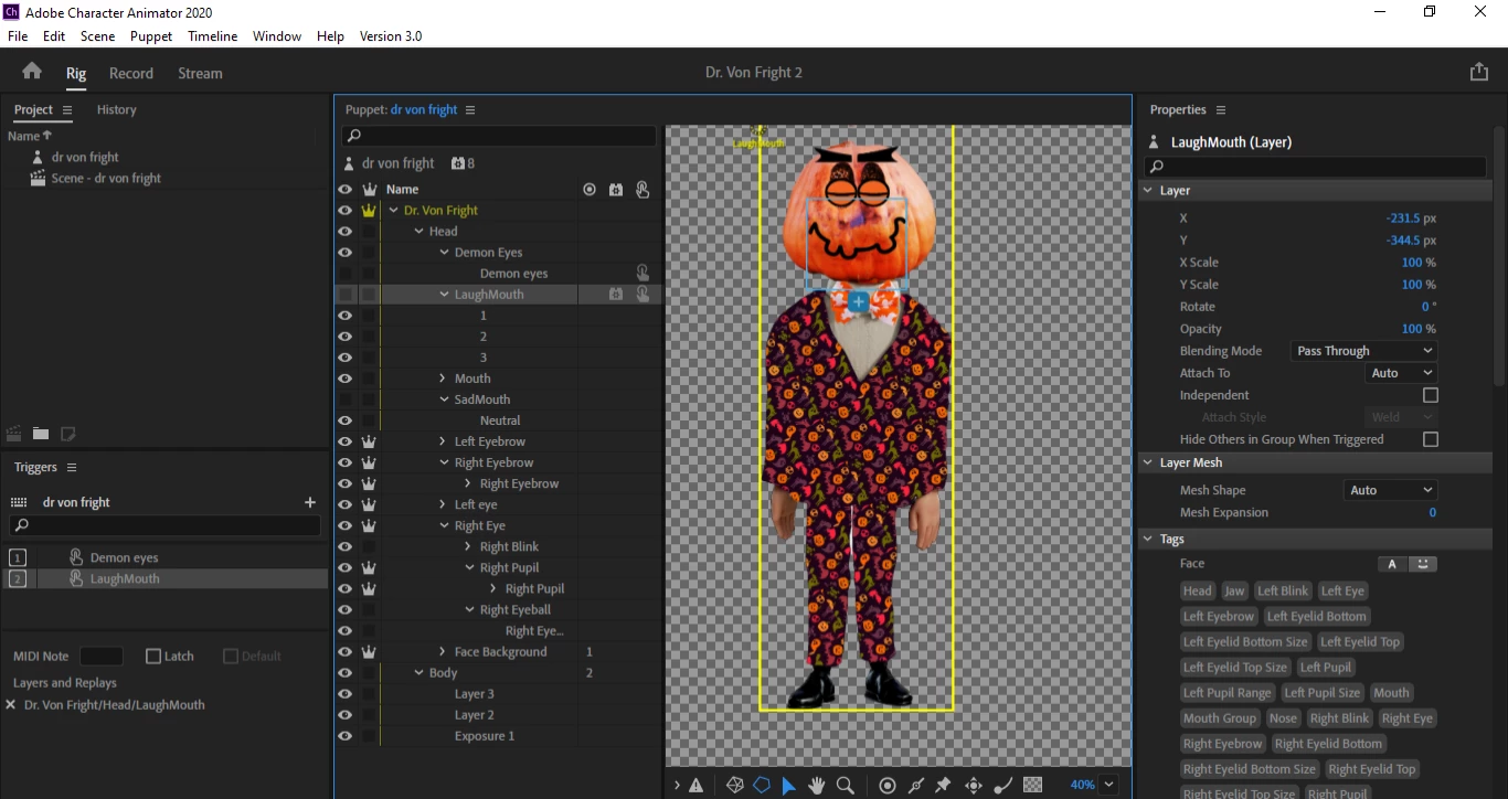

I want different sets of mouths and eyes to express different state of emotions of my puppet. When I make a group for the other set of mouths, and assign a trigger to it in CH it appears but on top of my normal mouths instead of replacing them when triggered. Hope you can help me because I was going to do several sets of eyes and mouths, but since I can't get pass this im stuck. How can I make my triggers replace other things from showing? I copy pasted a picture of how my puppet is set up for easier analysis.

Hey Alan, thank you for taking the time to answer. As I said I'm pretty knew to CH, so I find it a little hard to understand somethings I hope you can help me with a little further. Relative to the mouth problem, in my photshop file i have a separate folder of a laughing mouth I want to add, in the same hierarchy as the normal mouth. When i go to CH and make a swapset for this file and push the trigger It puts the whole laughing mouth on top of my normal mouth set, instead of replacinf it with the trigger. Where would you put this laugh mouth folder in hierarchy or what would you do to fix this?

Before I lead up you off the garden path, could you please confirm if you have a set of viseme mouth positions (Ah, Oh, Th etc) all smiling positions, or do you have a single expression (a big laugh)? If a big laugh, is there a reason you don't want to update the standard "Smile" viseme?
One concept to understand is Behaviors in CH look for tags on layers. CH automatically tags layers on import looking at the layer names. So a Mouth layer will have the "Mouth" tag added. But you can manually add and remove these tags. Be careful however as "Laughing Mouth" may be tagged with "Mouth" and Behaviors will try to manipulate it. So avoid the word Mouth if not a mouth for CH to control using visemes etc. E.g. I would consider renaming "Laughing Mouth" to "Laughing" (or "Laughing M") etc. if it does not have visemes under it.
I am going to assume you want single expressions (not lots of visemes), and you want more expressions than are built in (so Smile alone is not enough). Here then is how I would change your existing puppet structure.
Create a new group "Gob" (or "M Expressions" etc) and put your current "Mouth" layer inside it. Put Laughing Mouth and Sad Mouth inside Gob next to Mouth and rename to remove "Mouth" from the layer names.
So you would end up with something like:
- Gob
- - Mouth
- - - Neutral
- - - Ah
- - - Oh
- - - Smile
- - - ... (all the other visemes)
- - Laughing
- - Sad
Then create a swapset on Gob with triggers on Mouth, Laughing, and Sad. Make Mouth the swapset default. When you press the keyboard trigger for Laughing it will hide Mouth. (You can right click or something on Gob to create the swap set - don't have computer near me just now.) So you will end up with something like:
- Gob [with a swapset added]
- - Mouth [default]
- - Laughing [triggered by 'L' key]
- - Sad [triggered by 'S' key]
Because of the swapset, you you hit L or S it will hide the default for the swapset (the Mouth). But I would always make them siblings and not put anything else in the Gob group - it makes things clearer - all children are alternatives to be controlled by a swapset.
