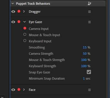

I´m personally not experienced in Photoshop, so figuring out how to mask an eyeball so my pupils can move inside was quite a challenge. No idea how i figured it out. Yet now i wanted to give my puppet some different kind of looks by switching eyeball shapes and pupils, but i can´t make it work.  Im already familiar with swap sets, but it doesnt help. Not sure how to hierarchy/group the extra layers.
There are some weird things happening, like pupils moving involuntarily without me triggering it in any way, or not moving at all.
Also, the already problematic eyeballs, now only come on the top of the old, regular eyeballs.
Here are my PS and CA screentshots, maybe someone had the same experience.  Thank you in advance.

this situation is really unusual, cause when my character is resting, eye gaze deactivated, the pupils are moving left, up, down periodically, altough im not doing anything and the video is stopped.

For the eye gaze, you may try adjusting the input parameters, maybe even turning off the camera input to stop that behavior.
