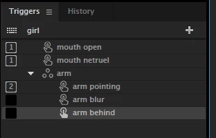

I've made the arm group into a Swap Set:

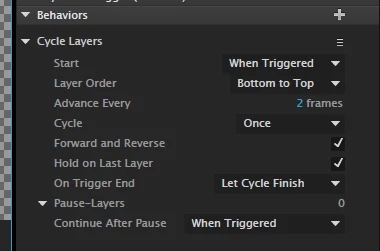

I've added the cycle layer behavior to the arm set:
So, my problem is that the trigger (swap set) works, but the cycle layer doesn't.
I don't get my 2 frame blurred in between arm.
How did I set this up incorrectly?

If I understand correctly, you want to hit the "2" key and have it show a frame of the arm blur, and then hold on arm pointing?
Instead of applying Cycle Layers to the arm group, put the arm blur and arm pointing into another group (in PS/AI) and apply Cycle Layers to that group.
So then your swap set should contain arm behind (set as the default) and the new group with "2" assigned as the key. Pressing 2 would then hide arm behind, and show first arm blur and then arm pointing (which could be made draggable to change where it points). Release the trigger would play it backwards and leave you with arm behind showing again.
