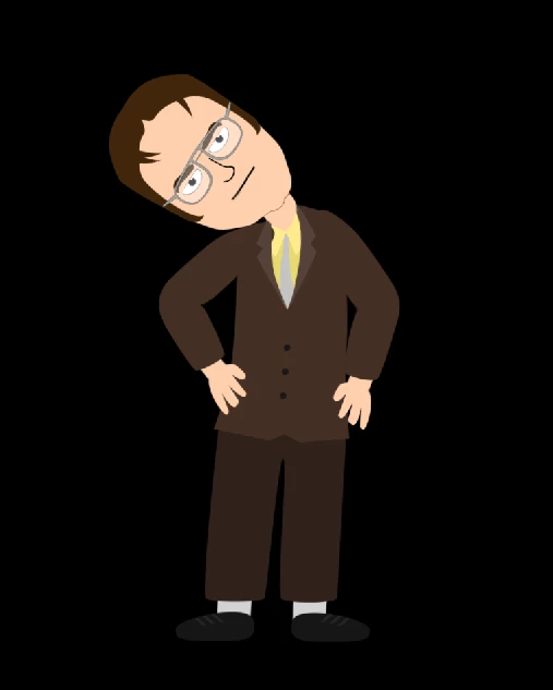

So I want my characters head to be able to to tilt at the neck without it tilting the entire body.
But i still want my body to move with the head so that the head dosent become detacthed, i just dont want it to tilt.

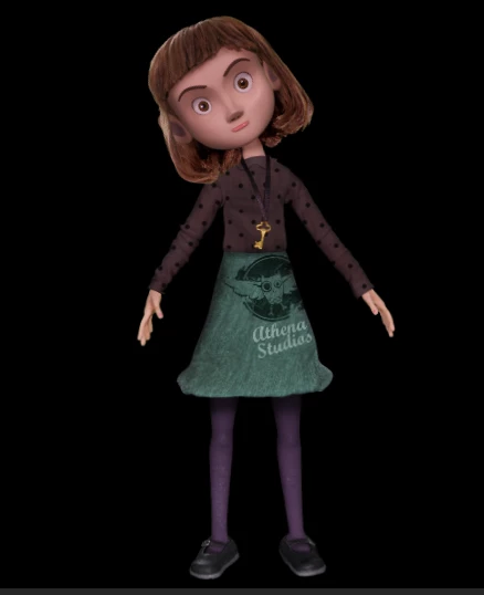

And I've noticed that the Maddy puppet from Athena Studios does this perfectly, but after spending an hour looking at how she is set up i still cant figure out what they did to make this possible.
Help?

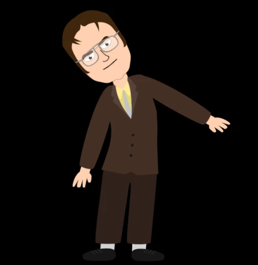

I've tried that but it just makes the tilt of the head and body stronger.
It's not easy to describe my problem, but i want my head to tilt alot whitout the body rotating alot.Just like with the Maddy Puppet.
As you can see, when Maddy tilts her head the upper torso and neck stay in aproximatly the same place which also leads to the hands not moving much.
But while my puppet tilts his head the neck and uper torso follows along leading to the hands to move alot to.
I want him to be able to cock his head without leaning the entire body over.
