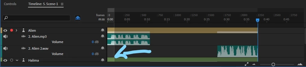

Hi Commmunity,
I have some problems with the timeline.
I am done with my project but there is a problem when exporting,it just export the first few seconds and the rest is a black-screen.
I guess the problem is from adobe ch (frorm my project).
I hope you help me because i need it for my school project asap.
Here is a photo:

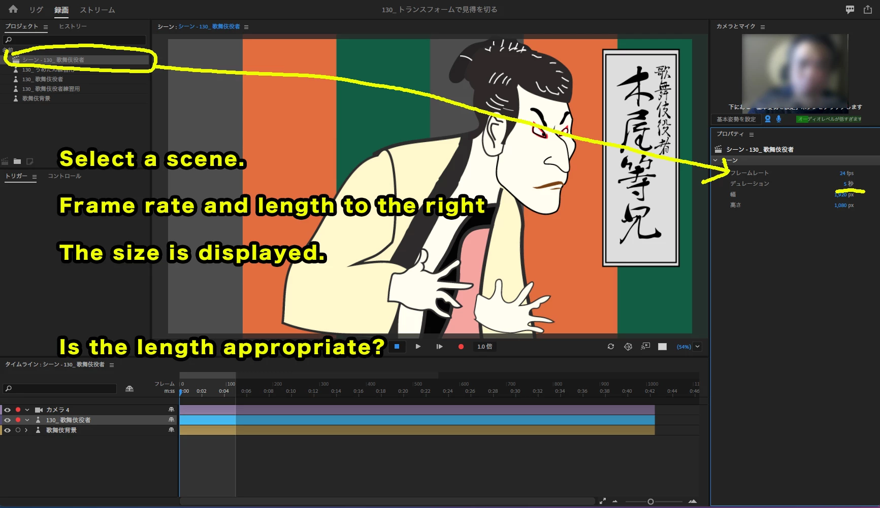

Hi Koshiro,
Thanks for your help.It is about the duration under the frame.
k_oshiro
Apr 11, 2021 1:28 PM UTC
Select a scene.
Frame rate and length to the right
The size is displayed.
Is the length appropriate?
k_oshiro(AdobeCommunityExpert)
Mthebest-ON-TopAuthorCorrect answer
Apr 12, 2021 4:49 AM UTC
Hi Koshiro,

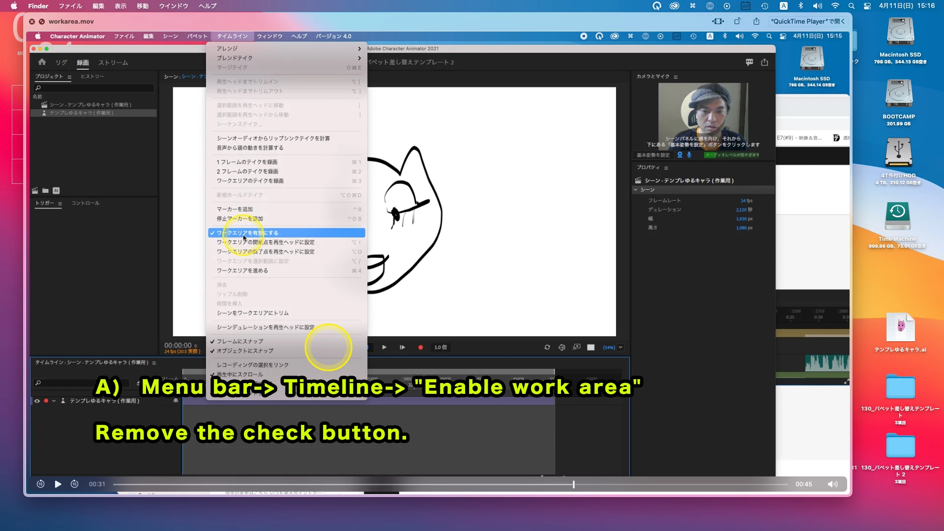

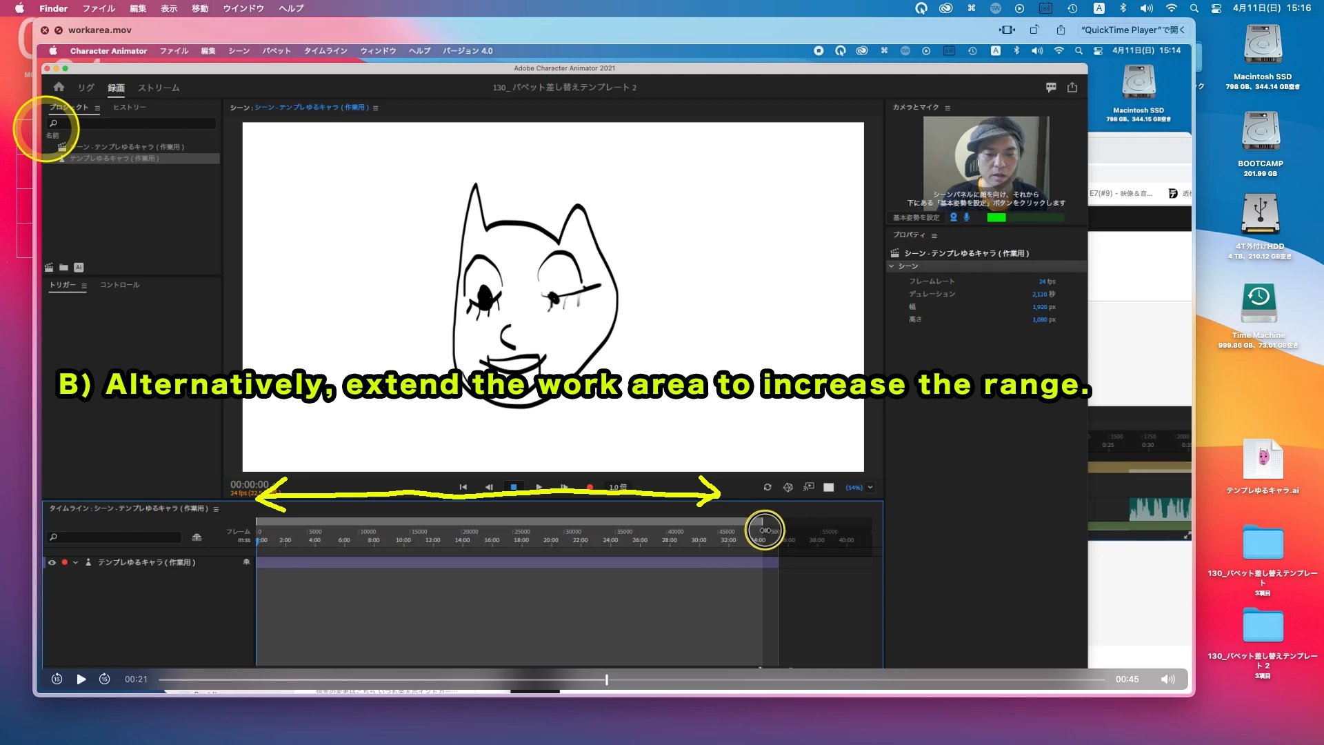

Apr 11, 2021 6:31 AM UTC
I converted Japanese to English with translation software.
A or B I think it can be solved by either method.
Probably because the work area is enabled.
A) Menu bar-> Timeline-> "Enable work area"
Remove the check button.
B) Alternatively, extend the work area to increase the range.
Thank you.

Apr 11, 2021 7:09 AM UTC
Thanks for your work, it is appreacited but the work area is turned off, and if i turned it on and resize it i still have the same problem.
It is not about the work area but concentrate on the end of line.It should be at the end of the timeline not at the beggining.
